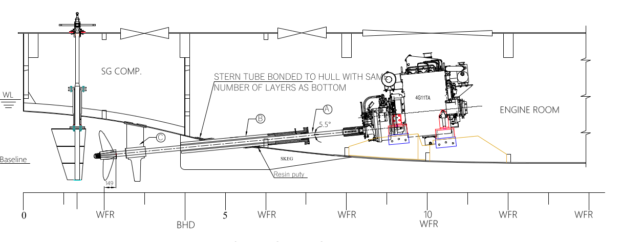

    Alby sent me a photo - but it is only 5 kb in size, and it doesn't help us very much.
    Alby, can you take some more photos please, at higher resolution?

    Are you certain that the propellers and gear ratios are engineered correctly for the boat? (Cavitation)
    Is there a chance that propellers/shafts could have sustained damage that pushes them out of spec?
    Is the clearance between props and hull surfaces adequate?
    Is the hull strong enough above the props and struts to resist flexing?
    Is the hull faired well in front of the props?
    You really need to post up a LOT more information in order to get anything other than guesses as response!

  8. alby joy
    Joined: Jul 2017
    Posts: 33
    Likes: 0, Points: 6
    Location: india
    alby joy Junior Member
    Hi,
    I am adding more pictures to get a clearer idea of the system

    The a-bracket inside boss we have a flanged bush which is tightened to a-bracket which is getting loosened. Hence request you to check the issue why these bolts are getting loosened.

    Are the A brackets mounted on vibration dampening mounts?
    If the A brackets are loosening; your shaft is running out. Test it.

    I am telling it again it's not the a bracket mounting bolts but the flanged cutless bush is loosening from the boss of a bracket.

    It sounds to me like you have a failed cutlass bearing in the A type bracket, but like I said, I am not an expert. I am qualified to ask questions.
    Curious why you would have an isolated problem in the star hull and then assume both hulls have a problem and ask about a prop change? I think that led a bunch astray here.
    Have you rechecked engine alignment? Uncouple and recheck by someone who did not do the install. The engine may have dropped since install.
    Then, have you checked the bearings? I am assuming we are talking about a bearing in the skeg/A styled bracket. If so, what are the clearances?
    Is the boat eating cutlass bearings? How old is the vessel and hours since prior cutlass install?
    If the install is new, has anyone checked for a bent prop shaft?
    Sorry, but it sounds like a routine problem that you have driven here as a design issue. Kind regards.

    This arrangement looks a bit questionable. How was the lateral vibration analysis done, particularly the stiffness of the propeller bearing? There may be a very basic vibration issue with the shaft that will only be cured by making a significant change. It is impossible to say for sure what change may be necessary without this analysis.
