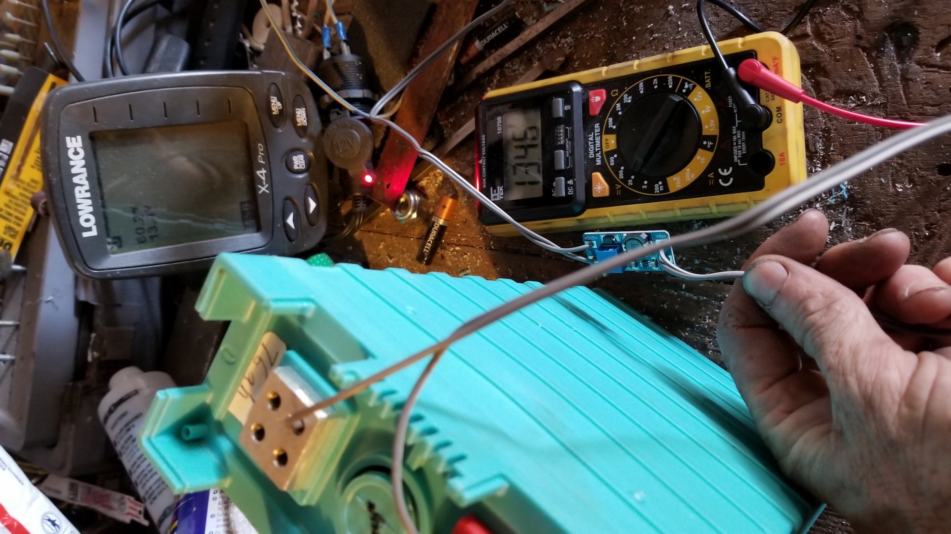

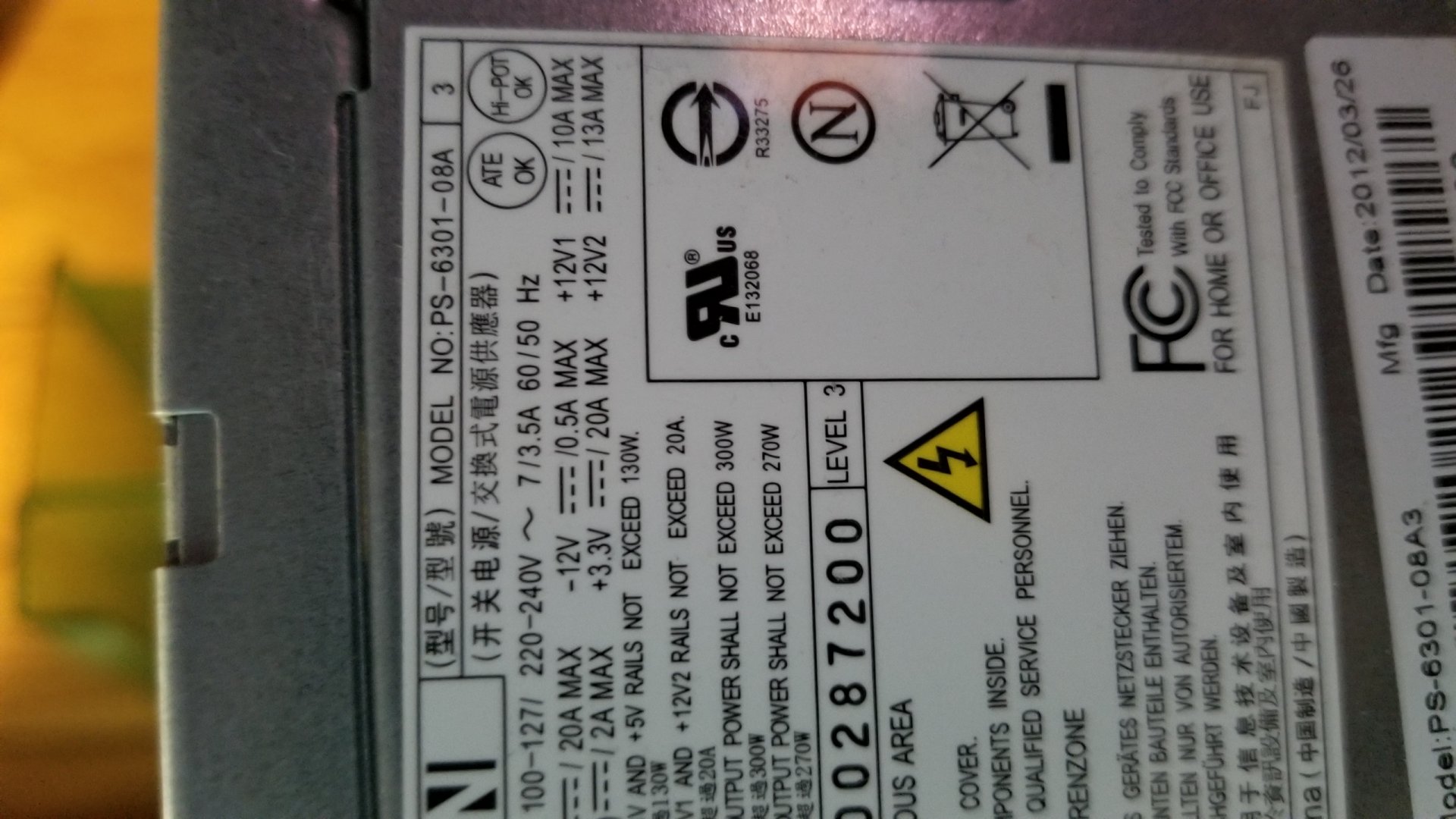

    13.45 volts, and fish finder is working from a single 3.2 lifepo4 cell. Now to charge it 1507849245488441317791.jpg Ok, it would be nice to read Chinese, 3.3 volts at 20 amps, should, get me by in a pinch.

    That is NOT a Cell, a Cell is 3.2 volts. It is a 4 cell pack also call a battery. You need to do more research before hurt your self or burn the house down.
    People have died and or lose hands, fingers!

    It is a 3.2 volt 100 amp/hr. LiFePo4 single cell, or perhaps a container of 3.2 volt cells in parrel.
    The 12 volts is off a converter. The lithium cobalt are the dangerous ones.

    The problem is, although a lithium LiFeP04 cell charges already by 2 Volt, your 3,3 Volt computer? power supply providing 3,3 Volt and 20 Ampere maximum may not charge your cell fully. I have never tried and actual are not able to verify this. I charge my cell 3.35 Volt and 50 Amph with 3.6 Volt although the manufacturer states not to exceed 3.65 Volt. This, I assume that 3,6 volt is basically 99% full. Your 3,3 Volt may charge the battery to 90% , SOWHAT? probably goo enough. Good choice to charge your cell in 5 hours when empty. You must just monitor the temperature. But 20 Amp of 100 Amp cell, means 0,2 C and I do not think your battery gets warm, nor hot during charging. I will try to get a 3.3 Volt computer power supply and see how it compare with my charging from 5 Volt down graded to 3.6 Volt. Bert

    I have always used 12volt lead batteries. So I am learning here.
    What I have gathered is that in a 4 cell battery, the first cell to become full. Will not absorb any electricity, so the 4 extra volts goes into and overloads the other cells.
    Lead acid, will just boil away electrolyte at this point.
    So charging a single cell of 3.2 volts, avoids this pit fall. And negates the need for special charge controllers, battery management systems, aka Bms circuit boards.
    With 12 volt lead chemistry, too much charge too fast makes alot of heat. We're the lifepo4 are built for speed charging, it's a good selling point. I would not think it is required,.
    The 3.65 charge voltage, of a 2hr fast charge equilizes at 3.2 .
    Just as a 16 volt charge into a 50% charged lead acid will show 15 volts on a volt meter, shortly after removed from charging. Then drop to 12.4 being only half charged.
    Same thing trips smart chargers on highly sulphinated lead cells.
    Electricity flows according to laws of physics. So 3.3 volts should bring a lifepo4 cell 99.99 full. The only thing I can think of that might cause problems. Is when the cell is 90% full. It might not be able to equilizes as fast as the 20 amps is flowing in, causing gas, heat. So the last 10% would be done with out the amp load.
    I would like to find a 3.2 volt 500millamp charger, just to see the effect. On its charge state, small solar charger. Maintainer charge.
    To think that after 10 years 1000 cycles of full discharge, they have only lost 20% capacity. My old deep cycle has lost 90 % in 300 cycles.

    Mark, I agree with you for most of it, but I am not too sure that if you keep the 3.3 Volt charger for extended period of time on the 3.2 Volt battery (actual mine are is 3.35 Volt when 100% full) whether there is really any damage to the battery. I assume the law of physics is, if the battery is full at 3,3o Volt (or 99.99 % in my case) and the charger is 3.3 Volt, there is no 20 ampere flowing into the battery. Maybe 1 milli Ampere or less. I think it just takes a little longer to charge the battery, as at 3,1 Volt the current starts tapering off. Maybe already at 3 Volt. I made a charger from an old 5 Volt computer power supply and if 3.6 Volt is reached, it switches over to constant voltage for 1 minute at 3.6 Volt. My official manufacturer specification does not state that I cannot charge it at 3.3 Volt. In my view, you can leave (like I do with my lead acid batteries ) leave for 1 month my battery at 13.6 Volt (just below the gassing voltage) and I have this done for 8 years and the batteries are still fine. The only problem is, that I sometime get some corrosion on my connection after 1 month and have to clean it. Thus I assume that if you keep the LiFeP04 battery at 3.3 Volt, I do not think you have a problem, but not for a month, but just some hours or maybe a few days. Are your LiFeP04 batteries really 3.2 Volt or also 3.35 Volt per cell. Bert

    Mark, I forgot to mention. For my 12 Volt ( actual 13.4 Volt LiFeP04) battery, I use my normal lead acid charger which charges till 13.6 Volt, I have not noticed that my 50Ah cells has had any negative behaviour over the 7 years. However at 13.4 Volt the current is only a few milli ampere and at 13.6 Volt micro ampere, It is a constant voltage charger at 13.6 Volt. Thus you should be able to charge your 100Ah cell at 3.3 Volt switch mode power supply module, without too many risk. Maybe you may have to place a small resistor in serial to avoid that the batteries still get an too high current. Bert
