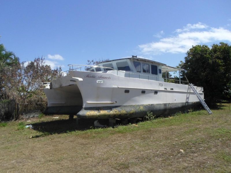

    Cruising Australia with Norm & Pip - https://www.youtube.com/watch?v=LPXNX6D521Q Nustar cat with twin 50hp diesels, not bad at all but a lot bigger than I want at this stage and we need more speed, 6 or 7 knots is fine if your retired and have all the time in the world also the build time for a 40ft cat would be at least three times longer than 24ft.
    If I wanted a 40 ft cat I would buy a shell mostly completed, they come up every now and then for sale, I almost bought a 45ft commercial cat up near Cairns, a victim of cyclone Yasi but too big a job to repair when you live 2000kms away.

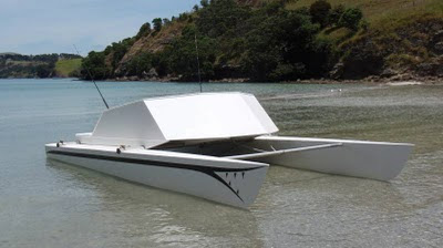

    What don't you like the look of ? The reversing sheerline ? It is a planing hull, low weight seems to be the key to getting it to perform. I can't tell from the picture whether the hulls are symmetrical, though possibly not. The deck clearance of 16" seems a lot. Lightweight planing cats can get quite scary at speed, I guess this one can't go fast enough with the small engines for that to arise.

    I think it must be the reversing sheerline, makes it look a bit odd to me, other than that it's all good.

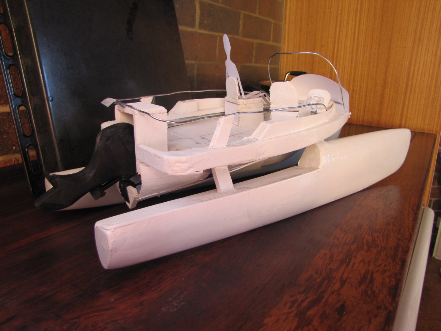

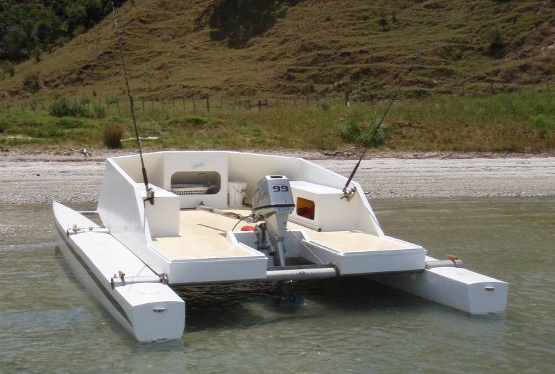

    I was intrigued with the tornado(?) hulls pictured. I have a pair of old tornado hulls that I want to use as a fishing platform. The photos show a scale (roughly made) model of what I had in mind and include a 30hp to scale and a 'person' about 1.8m tall. While I would like to centralise the weight, I think the outboard position is the best compromise and it frees up the fishing space. The pod is about 3.6m long and 2m wide and I think the all-up weight would be about 400 Kg including two adults giving about 20 knots speed. I apologise for the thread drift but I think it is obvious that many facets of your requirements and my design are similar except for the comfort of an enclosed cabin. I would be interested in comments about my design.
