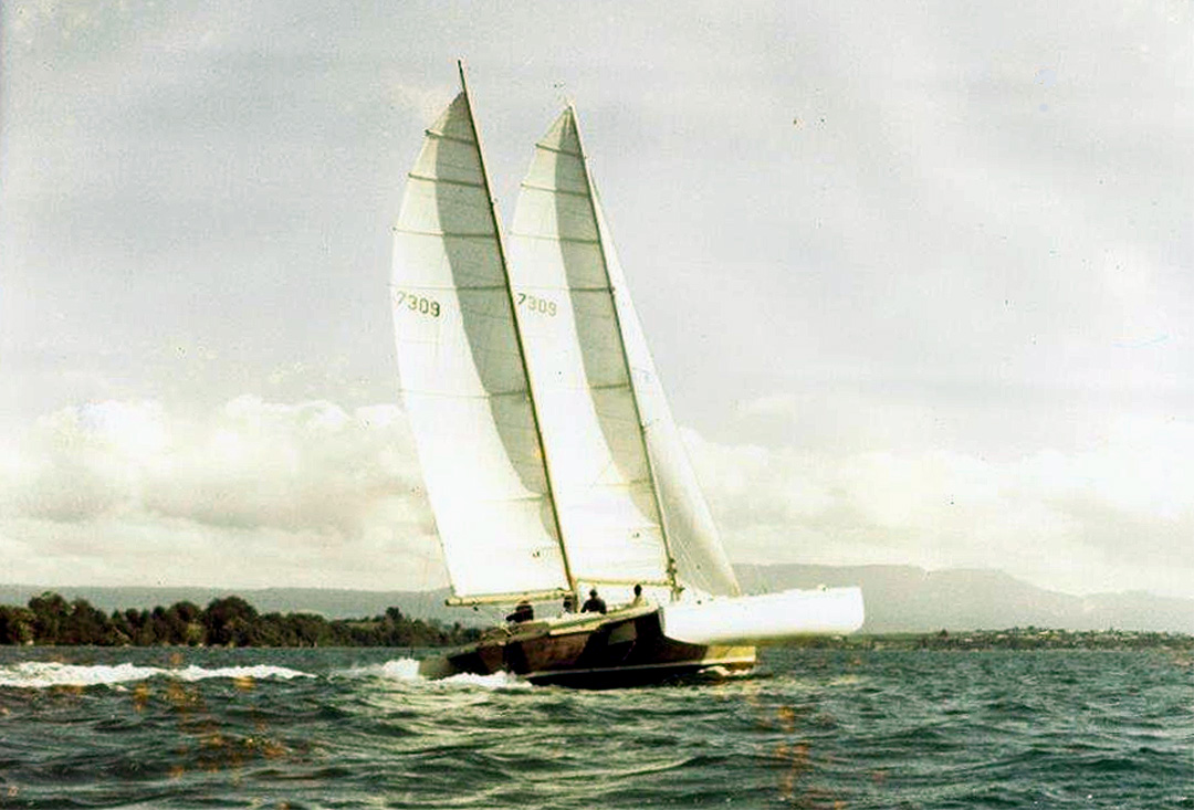

    Original sketch (cross between schooner and ketch - and not a drawing) rig on Jim Young's 40 foot trimaran Bladon Racer launched in the 1970s.

    I think the original US schooners have the shorter foremast - but then again, there are a couple of plans/drawings in Chapelle of equal height mast versions too. Young's Bladon Racer had equal rigs in height and sail area - and the after rig overhung the stern by a number of feet; also originally had float water ballast - which was automatically dumped from the leeward one but retained in the windward.
