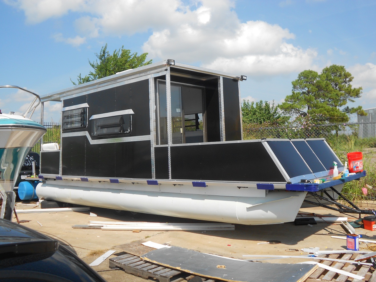

  11. luckyjr
    Joined: Aug 2011
    Posts: 33
    Location: houston
    luckyjr Junior Member
    This is a pontoon boat i just finished. Look to the rear the "blue" 36" x 24" pontoon with styrofoam I processed inside. These blue pontoons are hard as a rock and will not sink even if cut in half. I can force both into the water for max lift and stability while in my slip. I don't know what to expect while running? A video will show the results.
    This is a very low cost pontoon but how do you design it for performance? Most people could afford this larger boat and it is very very safe.
    Par, is that the direction you where talking about? Would a flat 24" channel on the bottom connecting the pontoons together do the trick? ears up or down?

  14. messabout
    Joined: Jan 2006
    Posts: 3,136
    Location: Lakeland Fl USA
    messabout Senior Member
    By using the word performance, I will assume that you mean that it should go fast without using collossal horsepower. Design for performance by forgetting the round pontoons and making them with fairly wide flat bottoms and sides.
    And by all means, put the notion of sideways cylinders in the verifiably counterproductive idea file.
  15. PAR
    Joined: Nov 2003
    Posts: 19,133
    Location: Eustis, FL
    PAR Yacht Designer/Builder
    Yep, the drums aren't going to be related to any level of preformance, by the normal means of describing it. Pontoons are fairly easy to build and again forget about the cylindrical shapes. Most of the design clues should come from, well, preformance power craft. There's a number of ways to go: flat bottom, slab sided, long, lean boxes which will be efficient and require the least amount of power, to asymmetric V'd shapes to milk the last ounce of ability out of the twin hull configuration.
