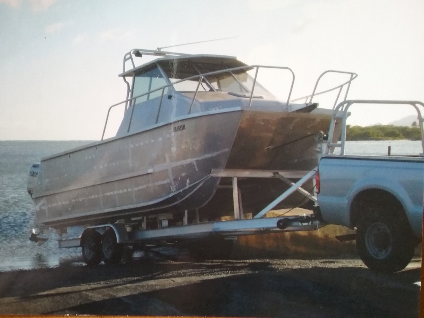

    Thank you for your answers. I had already seen the boatdesign forum on the stormcat / wildcat / skoda .... and also the spirit but my preference is stormcat. Here is 3 pictures of the stormcat but aluminium version. He looks great.
    Si I have some questions about building

    That "cushion" is a reference to compression of air within the tunnel, nothing to do with the internal structure of the boat. Having now seen the pics of the Stormcat, I'd say it looks OK to me, if it can be made in plate, it could be adapted to ply construction if needed.

    Certainly think the Stormcat is the right shape for the job, It is similar to the 23 Sharkcat, but without the flat along the demi-hull centrelines, which was probably designed that way to drive on and off the trailer easily, as much as anything else.
