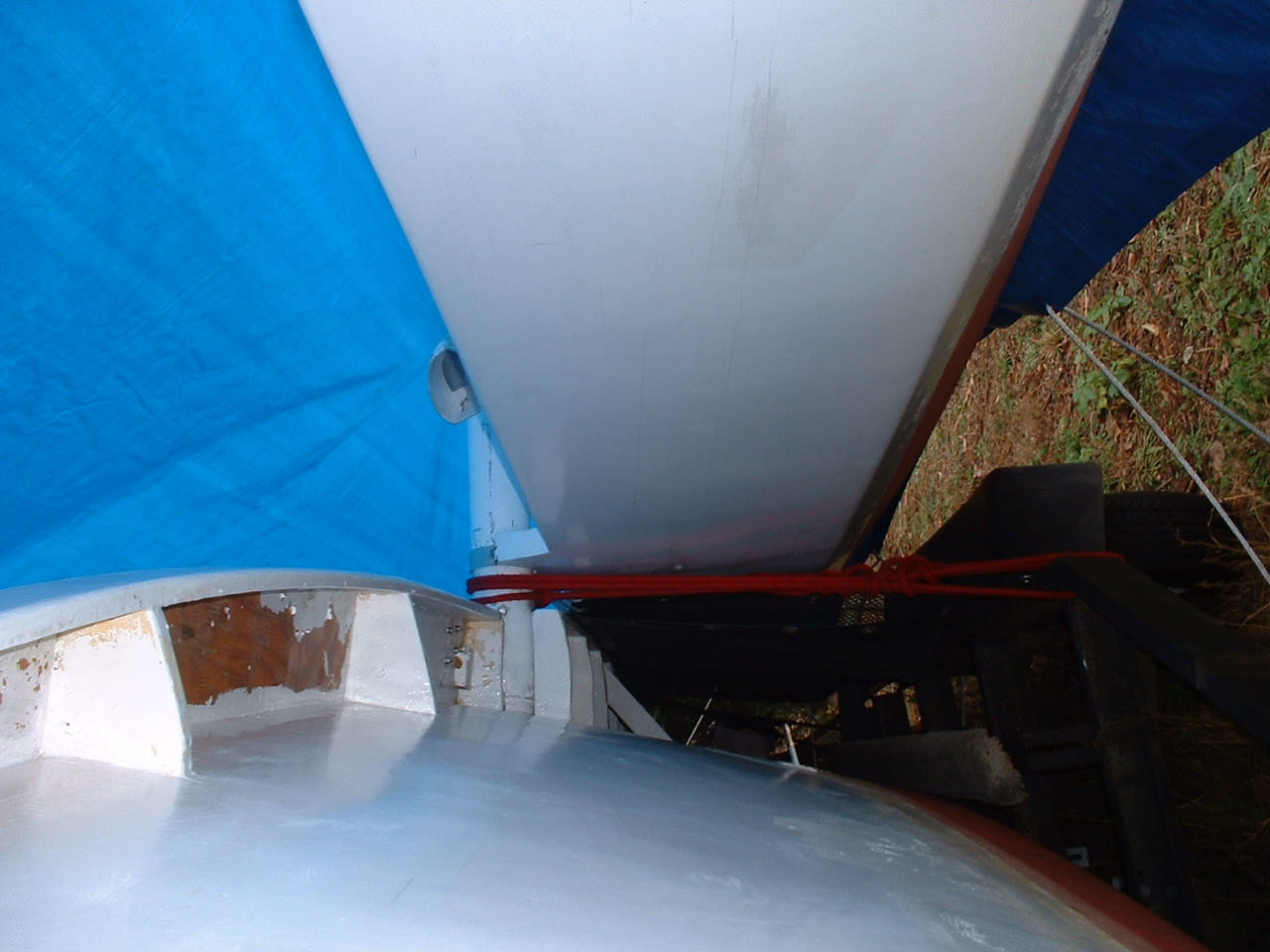

    Do you have pictures of the Bucc 24 on a trailer with amas demounted ready for travel? I wanted to see how this is trailered around. Thanks.
    Tatoski

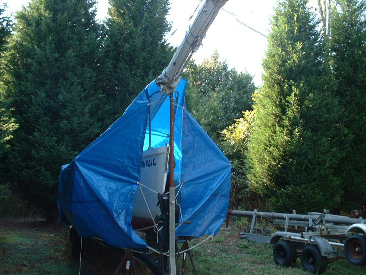

    trailer ready
    I have my cover on but I will post some more pics in a couple of days with out it. I have a system that I can do by myself, but a helper is nice and makes it go more quickly. You can see the fender below the port float. Bruce

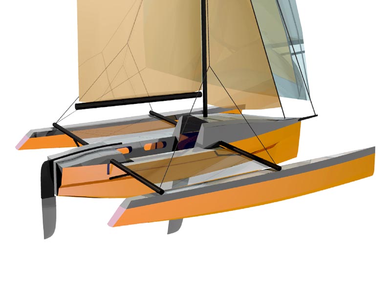

    what about this?
    Its loosely based on the Bucc 24 but with an updated cockpit and hull lines. Hard chine from 4mm ply the materials to build it are very very cheap, and very quick to build. The designer, Shayne Young says the vpp is quicker than a F9R...
    4mm ply is lighter than foam and glass (apparantly) so is a fairly good option for this sized boat if carbon is out of the price range.
    I am very tempted to build the floats for my boat...

    I reckon it would be quite a good boat, chines are something that I haven't discounted, but man would it be an ugly duckling:eek:

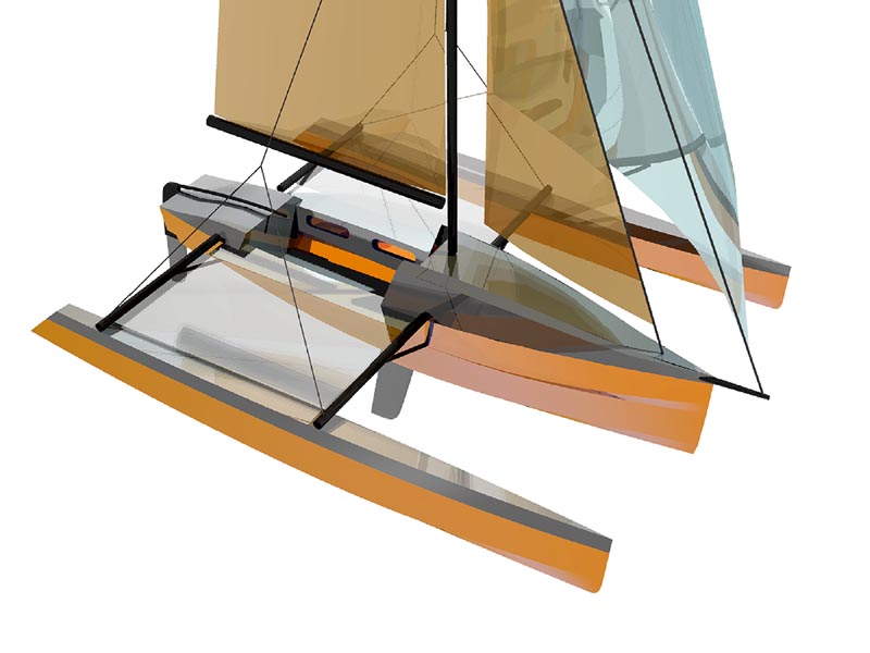

    I don't dislike that design approach, but I do prefer it when a plywood boat design does make an effort to create something more like smooth surfaces. Something like the drawings shown below is more along the lines of what I'd go for. Yes, there's a bit more work involved in the build.
    I also prefer it when the amas have a bit more height, which gets the boat up a bit off the water for a drier ride. Personal preferences, to be sure.
    This is a 16' LOA solo sport cruiser I'm doing right now for a guy who lives near me. I've been having a lot of fun working to his design brief and I like what is showing-up as a result.

    Neat boat Chris....:)
    How much can it carry ?
    How much sail area ?
  14. Chris Ostlind
    Chris Ostlind Previous Member
    Thanks.
    Displacement is 730 lbs. calculated against one 200 lb. guy, his personal camping gear, food, fluids, 2hp outboard, small can of gas and a fudge factor. It's a light boat in 4mm ply with glass/epoxy skins. I see the boat as a waterborne version of a lightweight hiking adventure.
    Sail area is 159 sq. ft. upwind with a 130 ft. screacher. Basically a modestly hotrodded Hobie 14 rig. Not looking for blistering, just spirited and easily controllable. It could go more nuclear if someone was looking to get that, but the base boat is more sedate. I like to use rigs from the thousands of ignored beach cats around the world. They're plentiful, can be had for little more than a smooth discussion sometimes and replacement sails are easy to come by, even when brand new.
