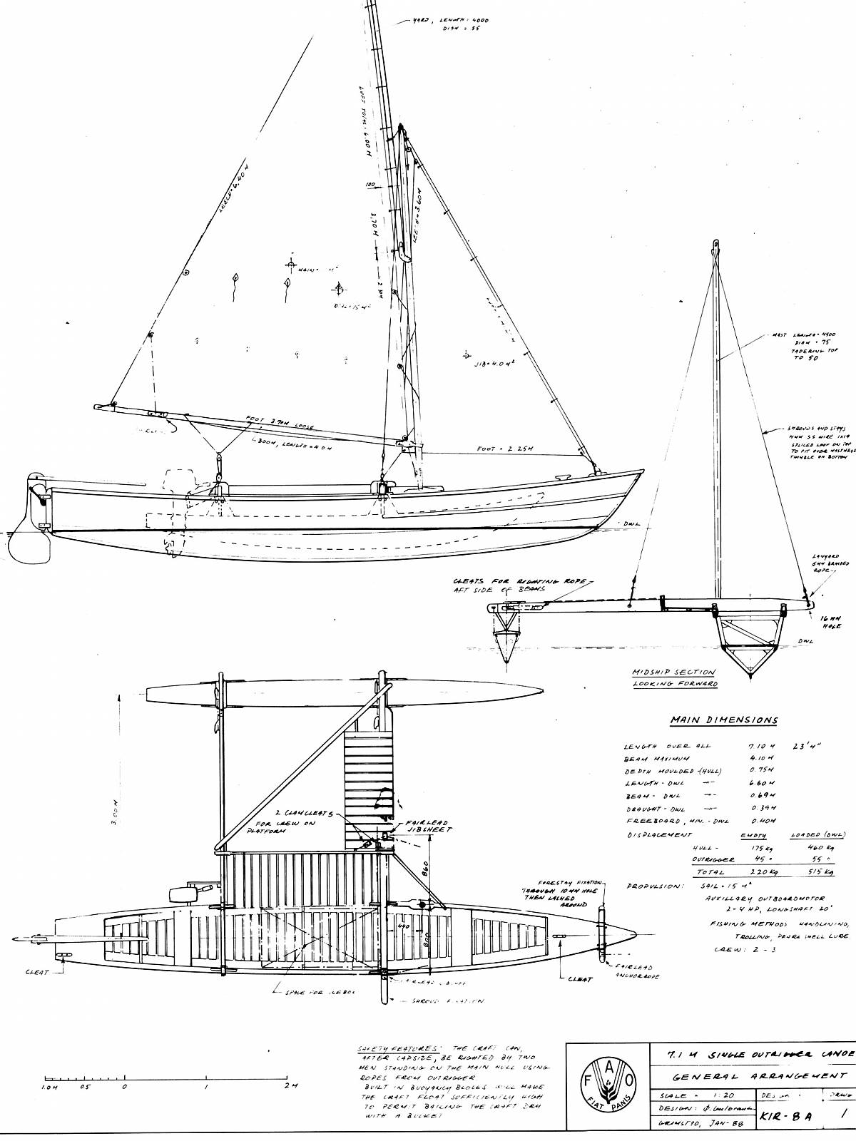

    @motorbike: what about something like this?
    It's called the KIR 8A, 7m long and made of 9mm ply. How much do you reckon a boat like that would cost overall? I calculated that the hulls would cost about a thousand british pounds. 432GBP for the ply, 380GBP for the epoxy and glass and another 300GBP approximately for the other wood needed for bulkheads, gunwhales etc.
