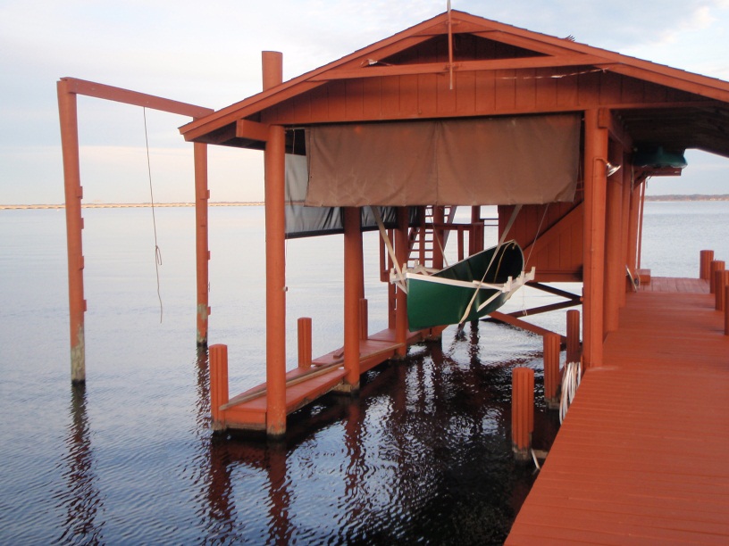

    I just completed a 21 ft 2 man rowing boat. I gave up speed for stability by using a flat bottom, although I am still getting around 4 knots with one man. Nice high sides that can take rough water. Please see pictures of the wood outrigger system. No need to purchase a row-wing drop in sliding seat and outriggers when you can make your own. Even the oars are long 2x4's with plywood faces. as soon as I figure out how to downsize my photos so that I can upload them I will...By the way, ripped down 2x4's to make them narrower and them put a groove down the middle to accomodate roller blade wheels. The padded seats I made each have 4 roller blade wheels, 2 per side that roll the seat up and down the rails. On a long row, it is your legs that are worn out, not your upper body. Kind of like sculling, but you can bring your girl and some beer. Plenty of room for everything, plus stable . I can stand up to pee. Try that in a rowing shell.

    I would say the boat is a "jack of all trades, master of none" but for me, it is the master of the water way. Perhaps a pulling wherry. Nice and wide at the midships, somewhat canoe like at the ends. A lean mean green rowing machine.

    One thing I would like to point out is the wooden outriggers. a 1x4 parallel to the sides of the boat allow the oars to rest upon the 1x4 and all the other wood serves to support this 1x4 or serves as a pivot point for the oars force as you pull them. Outriggers that far out from the boat allows much longer oars and with the sliding seat, maximum effeciency, at least for a flat bottom boat.
