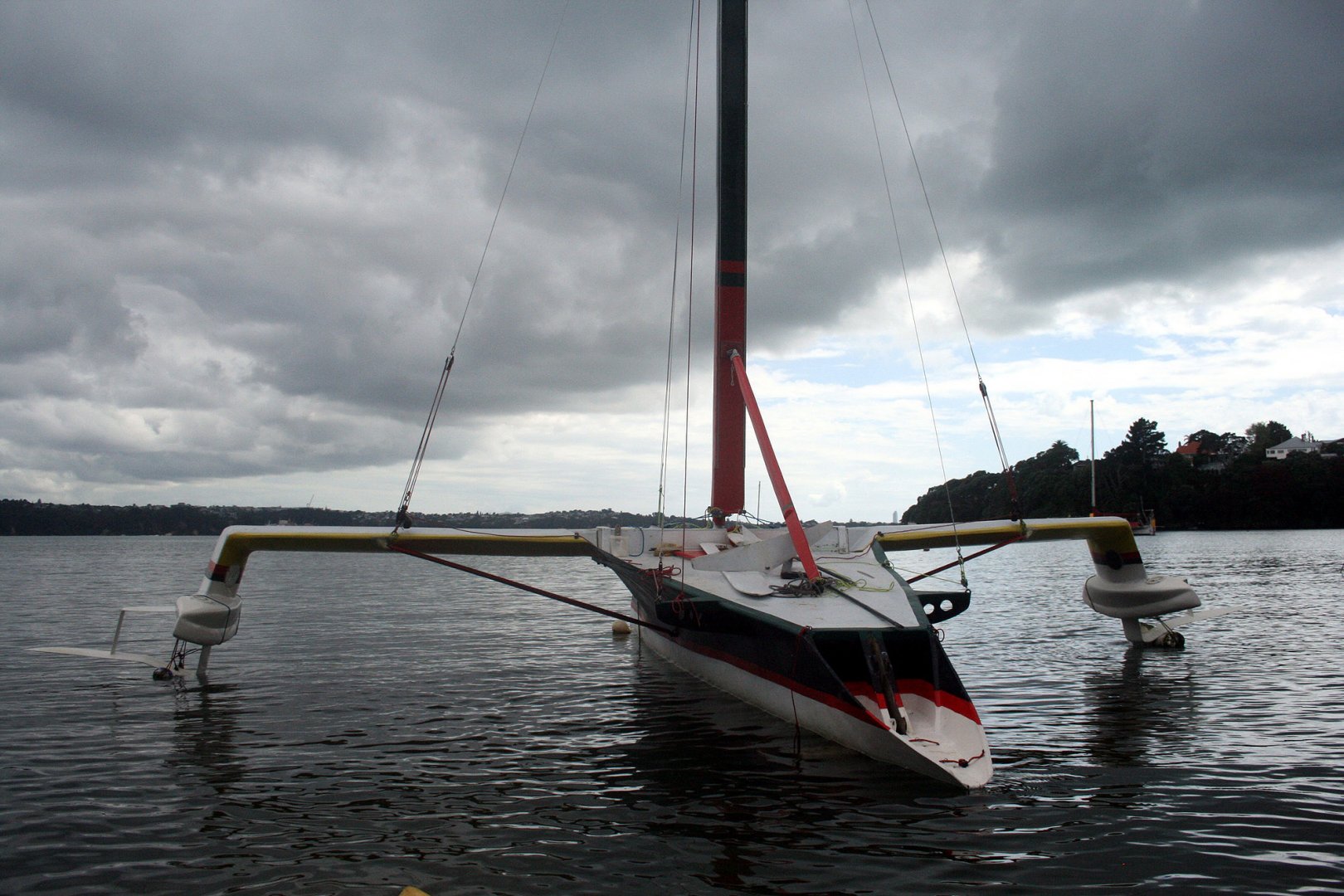

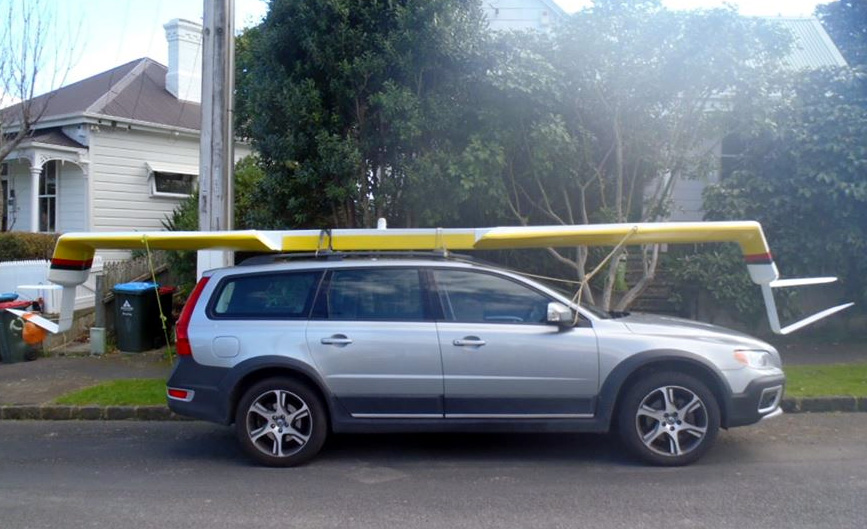

    There's always the possibility of a shortened Frog (huge royalties required - just joking) - which in its full size 7 metres square configuration with outfacing foils could be reduced to 6 metres?
  8. Doug Lord
    Posts: 16,678
    Location: Cocoa, Florida
    Doug Lord Flight Ready
    Since you don't know how to post the picture right I took the liberty of posting it below. Its too cool a boat to be relegated to a little thumbnail. Whats the difference between Frog and Groucho?
  9. Gary Baigent
    Joined: Jul 2005
    Posts: 3,009
    Location: auckland nz
    Gary Baigent Senior Member
    Just mouse hit the image Doug, suddenly it becomes large, magic? Foils and floats have been enlarged since the earlier picture, very big improvement. Thought originally I would get away with no floats, just the angled down beam and foils, was very wrong.

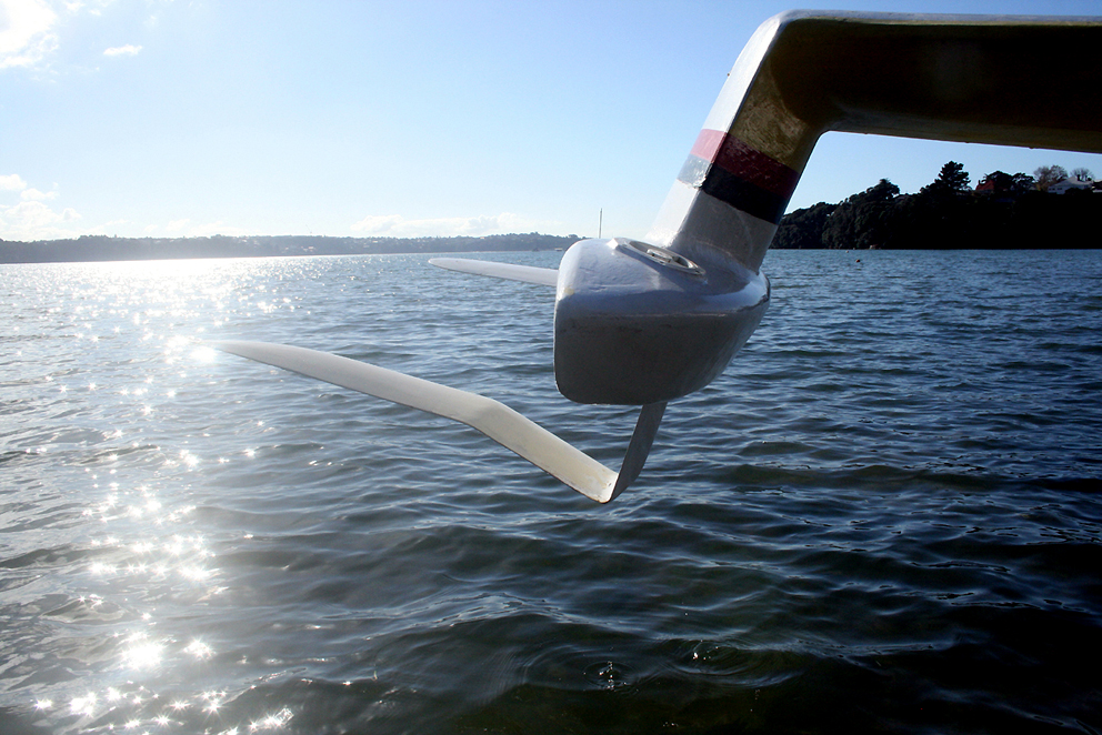

    Hi Gary, could you give details on materials and building of the angled foils ?

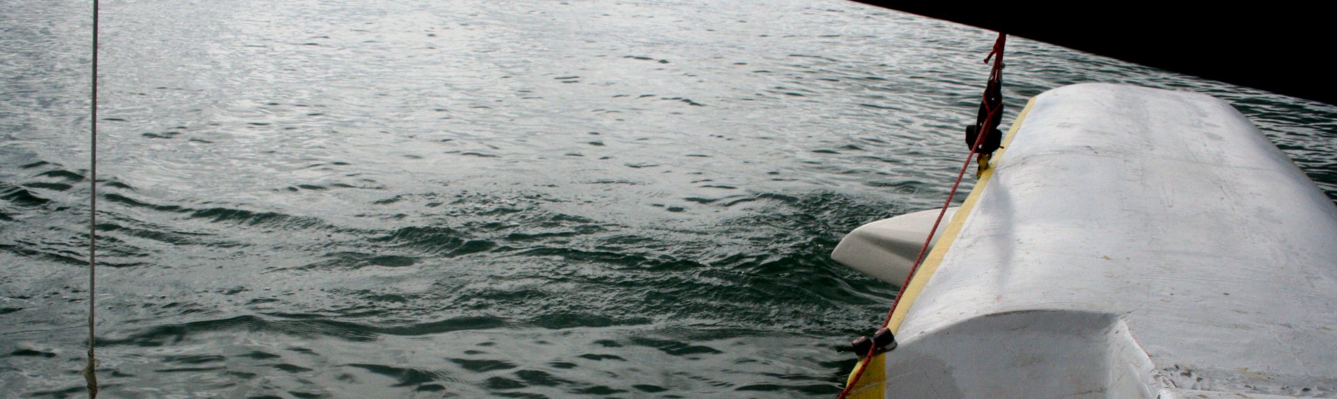

  11. Gary Baigent
    Joined: Jul 2005
    Posts: 3,009

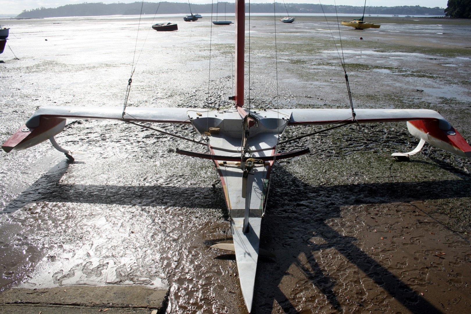

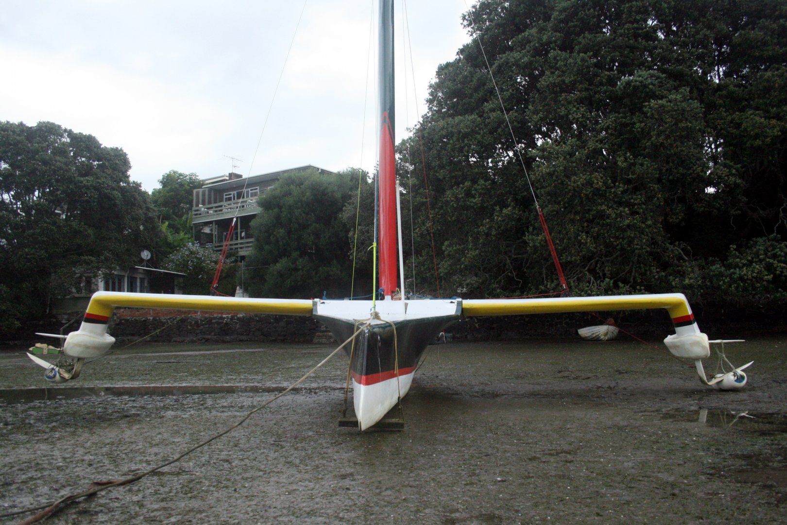

    Nothing special, Patzefran. Here's the originals with no floats - warning, don't do this, thought the upper foil would reduce tipover, it doesn't. Second image is with float and increased span main foil, tipped down so as not to ride out of water when lifting off. Some may disagree with this. Third image: leeward float has again been altered, flat bottom, larger area and the two foils connected with a strut - to stop flexing.
    Materials are primitive/simple: strip planked light wood with glass and some carbon reinforcing in the curved areas.

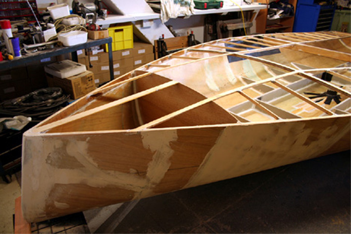

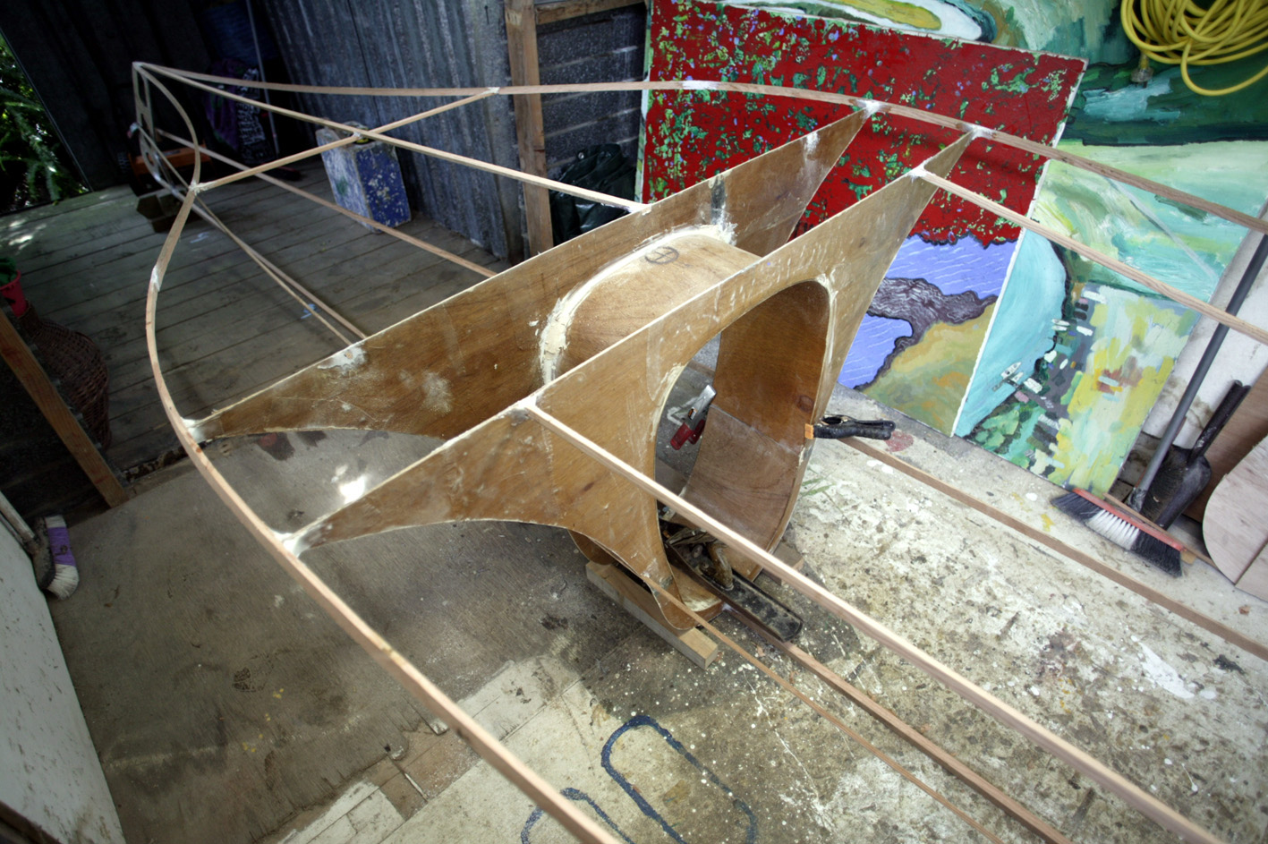

  13. Gary Baigent
    Joined: Jul 2005
    Posts: 3,009

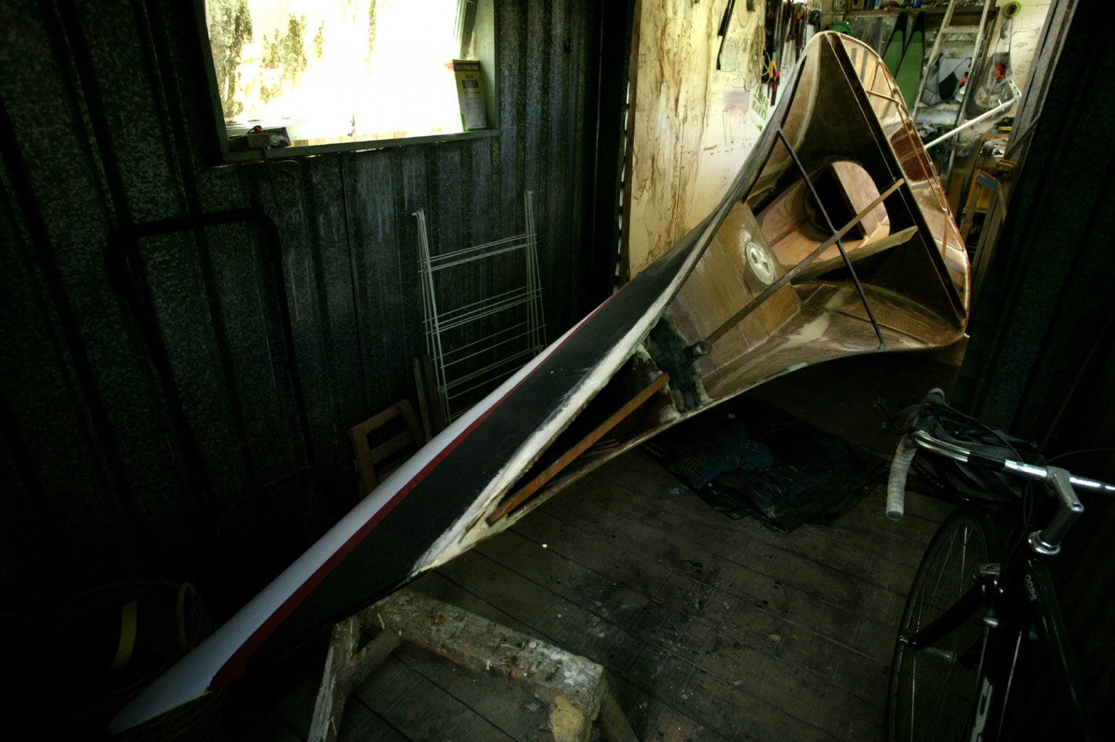

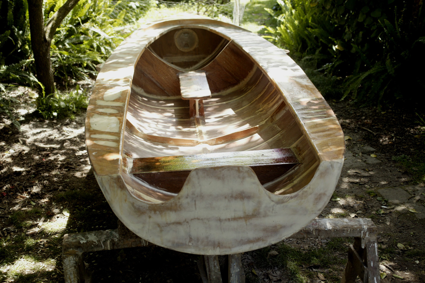

    The Gougeons' book has a chapter that thoroughly covers tension ply construction; can download it online.
    My experience for what it is worth is that you need thin ply, thinner the better ... because once you have shaped the hull you lay on glass/carbon/Kevlar to beef up hull thickness.
    Getting high rocker shape to keelson is tricky, hence my boats have near flat rockers - which produces a faster hull anyway.
    To get a double curve in topsdes (to get flare) requires that you first bend the bottom half, epoxy coat it, then when cured flare the uncoated top section out to the wider gunwhales. It is difficult to explain this properly - hence the photographs. If you run into difficulty you can always strip plank in ply or veneers instead - but much slower build time - second photograph of rowing skiff.

    Thanks, Gary, I was speaking of foils ! Anyway your comments and photographs are very interesting.
  15. Gary Baigent
    Joined: Jul 2005
    Posts: 3,009
    Oh, sorry Patzefran. My asymmetric foils are simple, just bent thin lengths of wood around formers, clamped and glued. I rout out the high load areas and fill with uni-carbon, then glass over.
