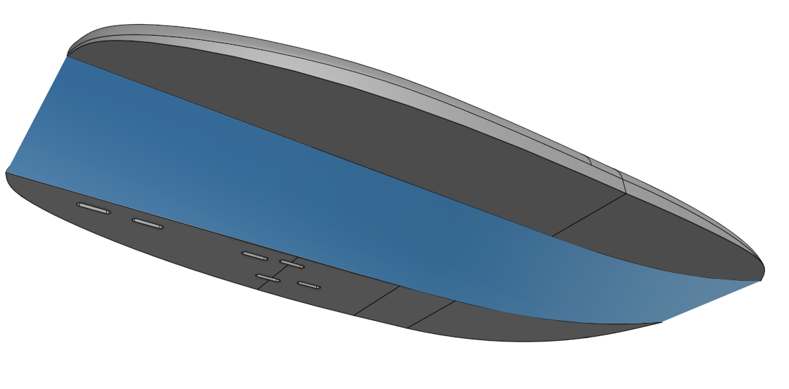

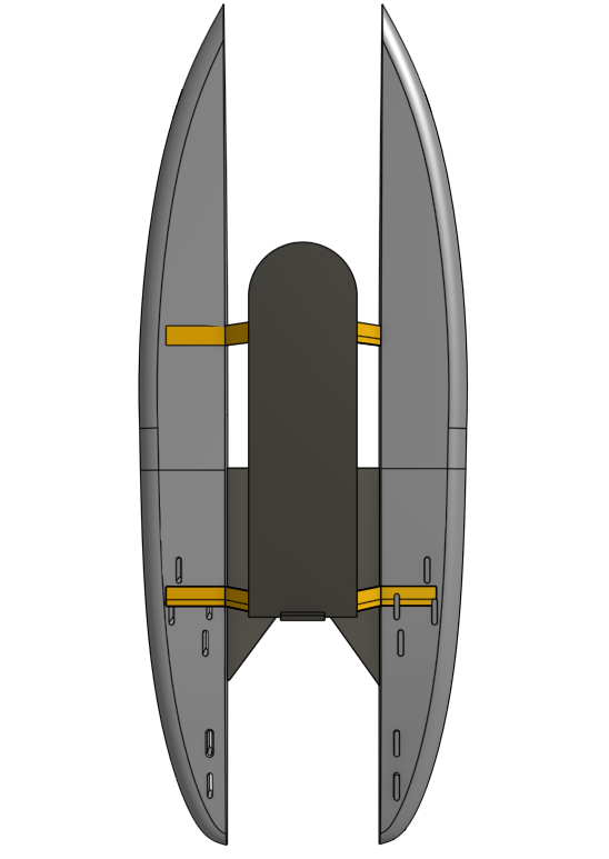

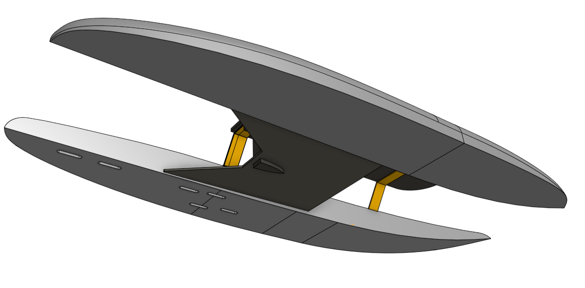

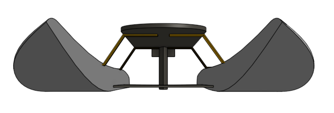

  13. NoviceJoe
    Joined: Jul 2020
    Posts: 13
    Likes: 4, Points: 3
    Location: Dorset
    NoviceJoe Junior Member
    This is turning into a very interesting discussion for me. Many of you clearly think that this is just not going to work for various reasons, such as; lack of power, too small an area for planing, rocker, hull efficiency, too narrow, weight distribution etc. But, some of you obviously think that there may be a way (with some tweaks) to get this boat to go over 10mph which is the goal. I have learnt a lot about boat design in the last few weeks and that is as much fun as anything else. I am already pleased that it floats, is stable and can do 8mph. Thanks to all of you who have contributed thus far.
    The pedestal idea I had that someone else suggested proved to work really well for alleviating my prop ventilation issue, it also has a little plate on the bottom. As mentioned before it didn't translate into higher speeds but was much smoother. I have had another idea that I could integrate a tertiary planing hull, roughly along the lines of the drawing below. Please excuse the crudeness of the illustration I'm completely new to CAD as well! The idea of this is obviously to increase the planing area of the hulls. I envision it to be flat with the hull bottoms but have a slight rise in the front of it. I am thinking of raising slightly (maybe an inch or two) from the height in the illustration so it is just below the natural waterline. As soon as the boat moves forward it will clear itself of water and contribute significantly to lift.
    What do you think? Should the whole thing be at an angle? Does it need to have its own bow to deflect water over the hull decks? Will it just be continuously water logged and have a negative effect?
    I have a higher pitched prop coming later this week and am still considering cutting about a foot off the stern of each hull (perhaps between the toe strap fastening plates). This will be the last resort.
    NB: The aft 140cm of the hulls are virtually flat, so I am not too concerned about the 'rocker' effect.
    Sorry if I have broken forum etiquette but this is also posted in the hydrodynamics section on this site (I have two concurrent threads going) oooups.
    portacruise likes this.

  15. Rurudyne
    Joined: Mar 2014
    Posts: 1,170
    Location: North Texas
    Rurudyne Senior Member
    Suggestion: those table legs would make a great place to mount extra structure, supporting a pair of upside down buffet/serving tables either side of the main table and carefully positioned to serve both as stabilizing amas and for wave drag reduction effects.
    Also, for wave system resistance reduction it may help to use an old executive board room table, as they are much longer, affording better opportunity to place the buffet tables farther aft from the bow.
