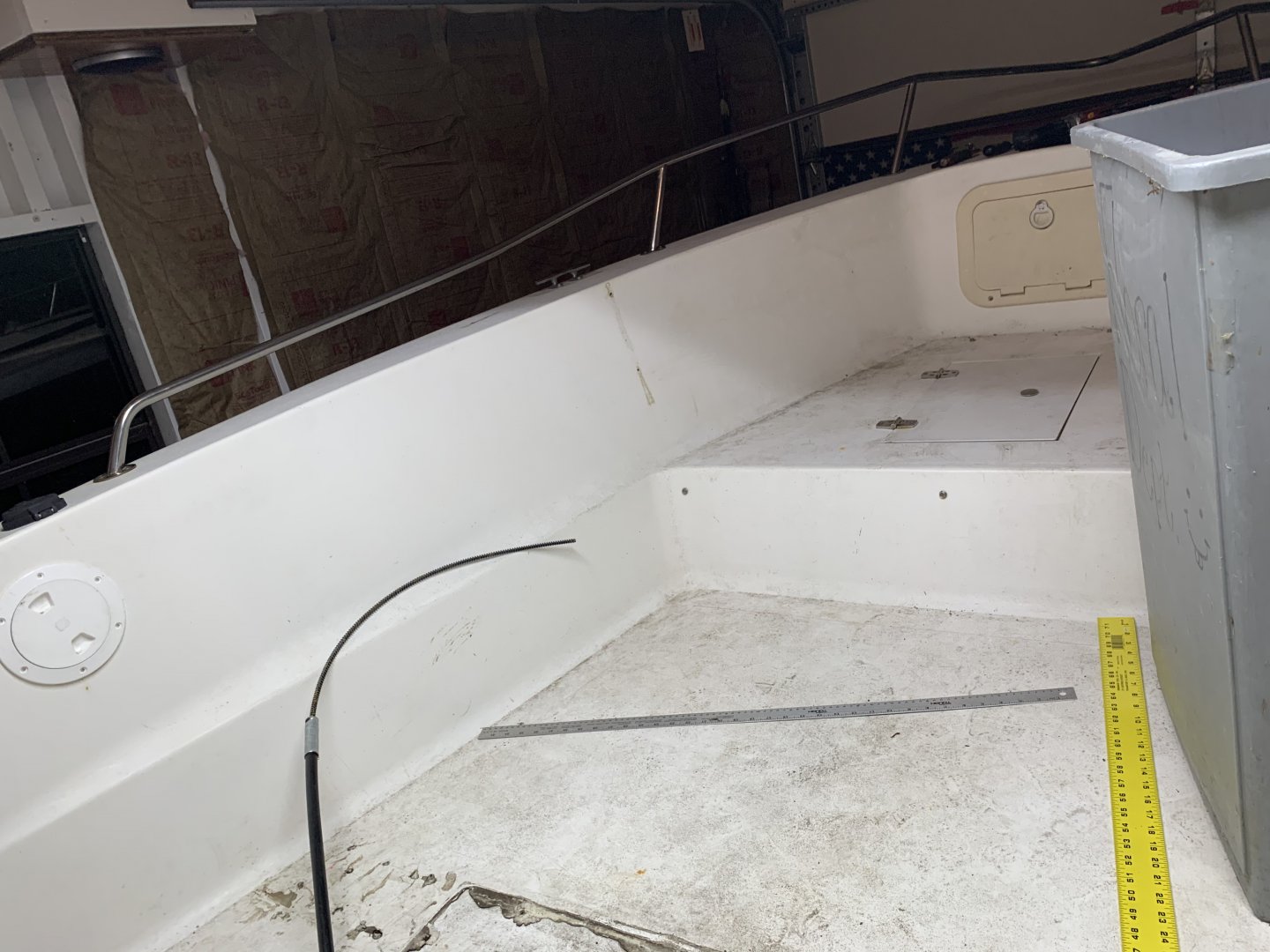

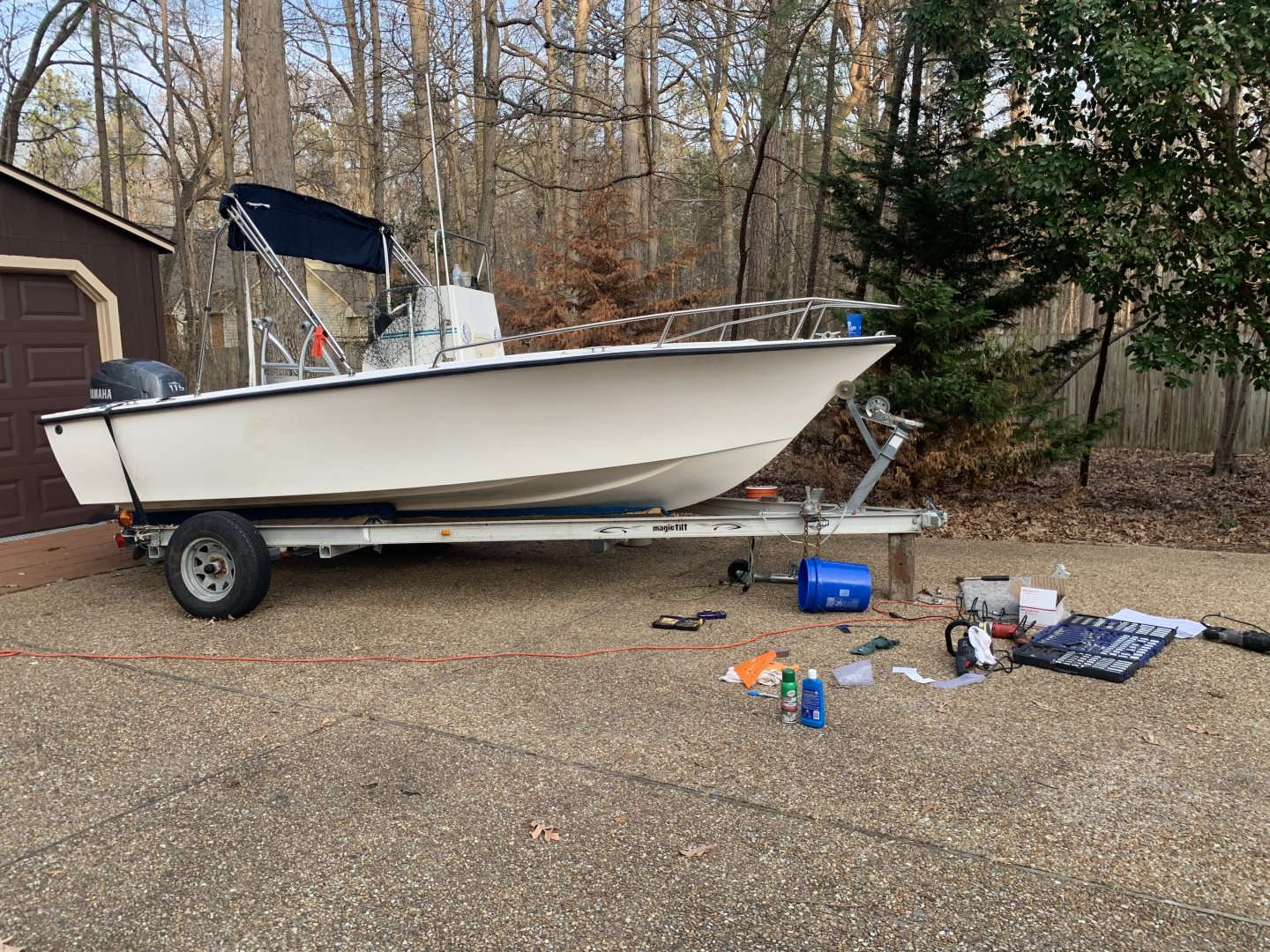

    Ok, so I have a 95 Sailfish 176. Deck is rotten. On this boat the deck is actually integral to the cap as far as I can tell. It’s all one piece. Has anyone ever replaced a deck in a boat like this? I’m hoping it can be done without removing the whole cap. My plan is to cut around the edges about 2.5” from the sides and remove everything and go from there. Probably replace all the foam, possibly tank, check out stringers, etc. Pretty sure I glass the underside of the new deck pieces, then topsides up onto the liner/cap after grinding the gel coat off a bit. Not sure why but I’m worried about how to blend the glass I lay up onto the liner so that there’s not a line of some sort. Guess that’s what fairing compounds are for. This far I’ve only cut my teeth on repairing some glass and all the cracks and chips on the console. It’s smooth as butter now and primed with 2 part poly. I plan to paint the whole boat when complete. I’ve had other boats in the past but never a project like this. It was pretty cheap and came with a good Yamaha f115 so I figured why not? Give me some encouragement, I need it!

    Might be a good idea to cut more like 6” in and leave a 2” or so gutter around the edges.
    Then incorporate enough crown in the new deck to shed water to the gutters, and out the scuppers.
    This could put the glass joint at the inside corner, rather than up the wall, cleaner looking and easier to hide.
    Many rotten decks are victim to sagging, which promotes the rot problem.
    Apparently manufacturers don’t see this, As flat decks are the norm.

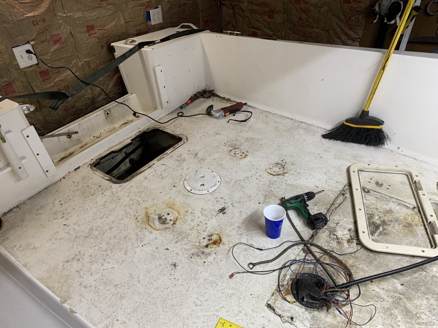

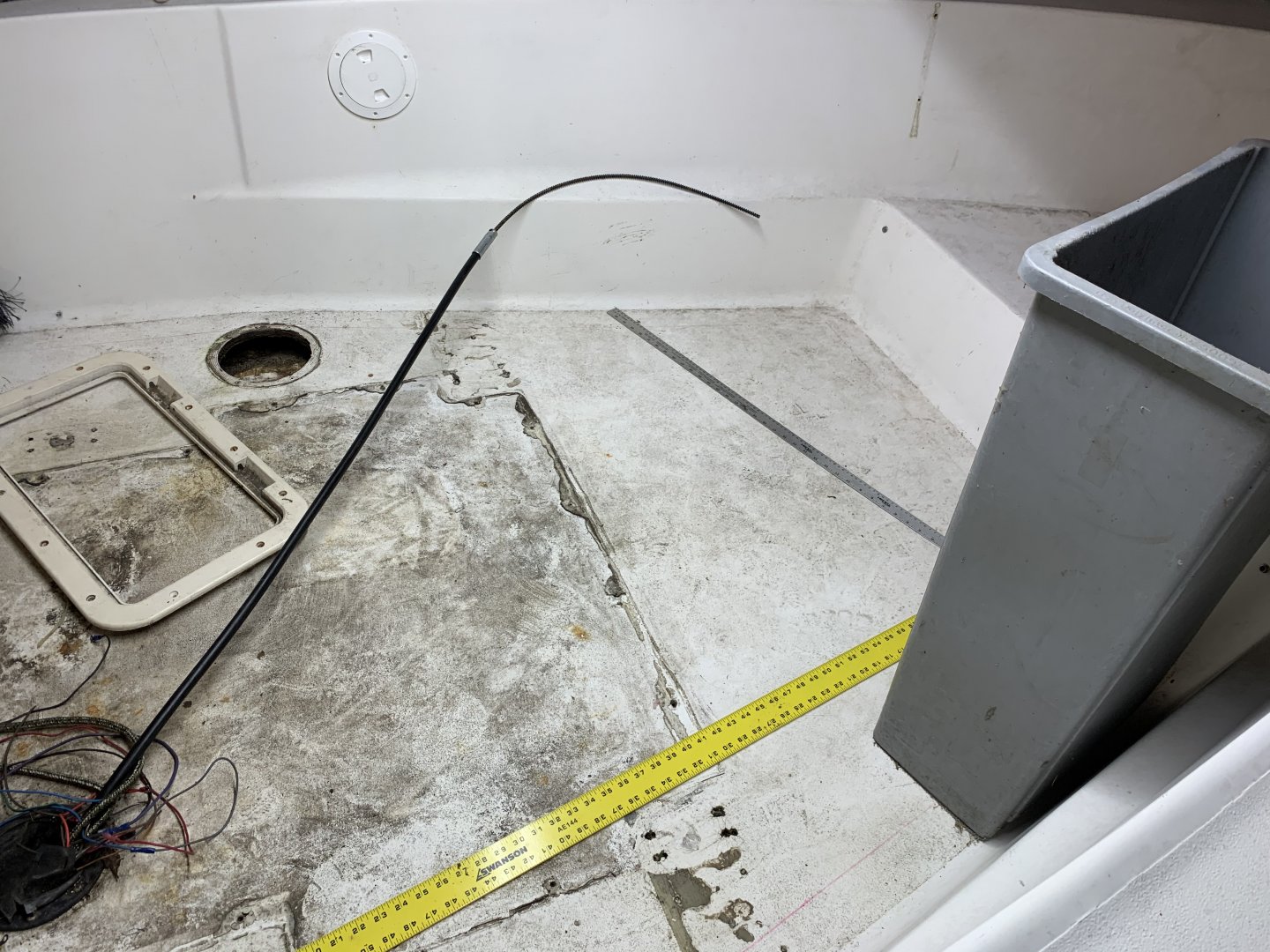

    Thanks for the replies. Got some work done last night. Pulled the top skin off in 2 pieces. A mess of wet and rotten plywood squares is what I found. Started cleaning it up thinking I could save most of the bottom skin and only remove a portion but I think it all has to come out tonight to dig deeper into the hull and check more things out as suggested.

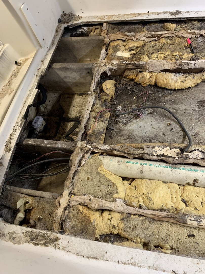

    Little more work done. Drilled into a bunch of stringer sections. Some spots dry, some spots wet, some spots real wet. Gonna pull some foam out next and keep checking them. Definitely very far from breaking up on me. There’s a couple 2 ft long gelcoat cracks on port side so I think I’ll remove the foam there down to the hull and check there next. No other stress cracks on the hull that I can see. Drilled down into the transom bolt holes and it’s dry as a whistle there. Many older but sealed screws in the transom I’ll pull later at some point.

    Dumb question- looking through the hull compartments and cutting out the foam I’m finding that anywhere from a quarter to an inch or two of the deepest areas have absorbed water. The vast majority is still dry. Is that a positive or a negative? I think once I get all the foam out I’ll take some bigger core samples of the stringers. Should I use a hole saw? How big?

    Big enough to get a real snapshot of the stringer, I’d start with something like 2”.
    Don’t go clear through, just one side of the glass and the core to make repairing the divot easier, if you need to.
    Take the arbor bit out once the holsaw is well started.
    I’ve explored stringers with a Long 1/4” bit, drilling from the top down, just be careful not to drill into the bottom laminate! (Mark the bit with tape at appropriate depth where you’re drilling)
    If the laminate over the stringers/bulkheads is heavy, you may be ok even with rotten wood.

    That is a pertinent observation. If it is just a case of minimal tabbing or encapsulation, then the timber is doing the lion's share of the structural "work", but if the encapsulation is substantial, then the rot may not be the end of the world.

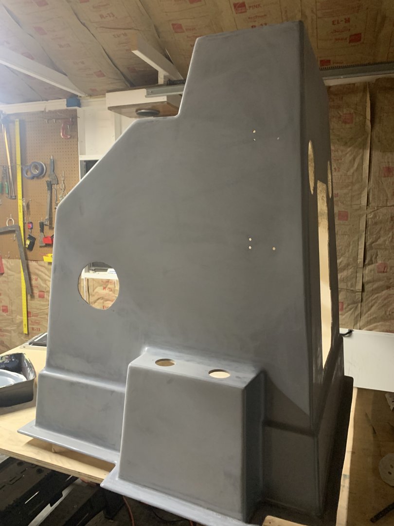

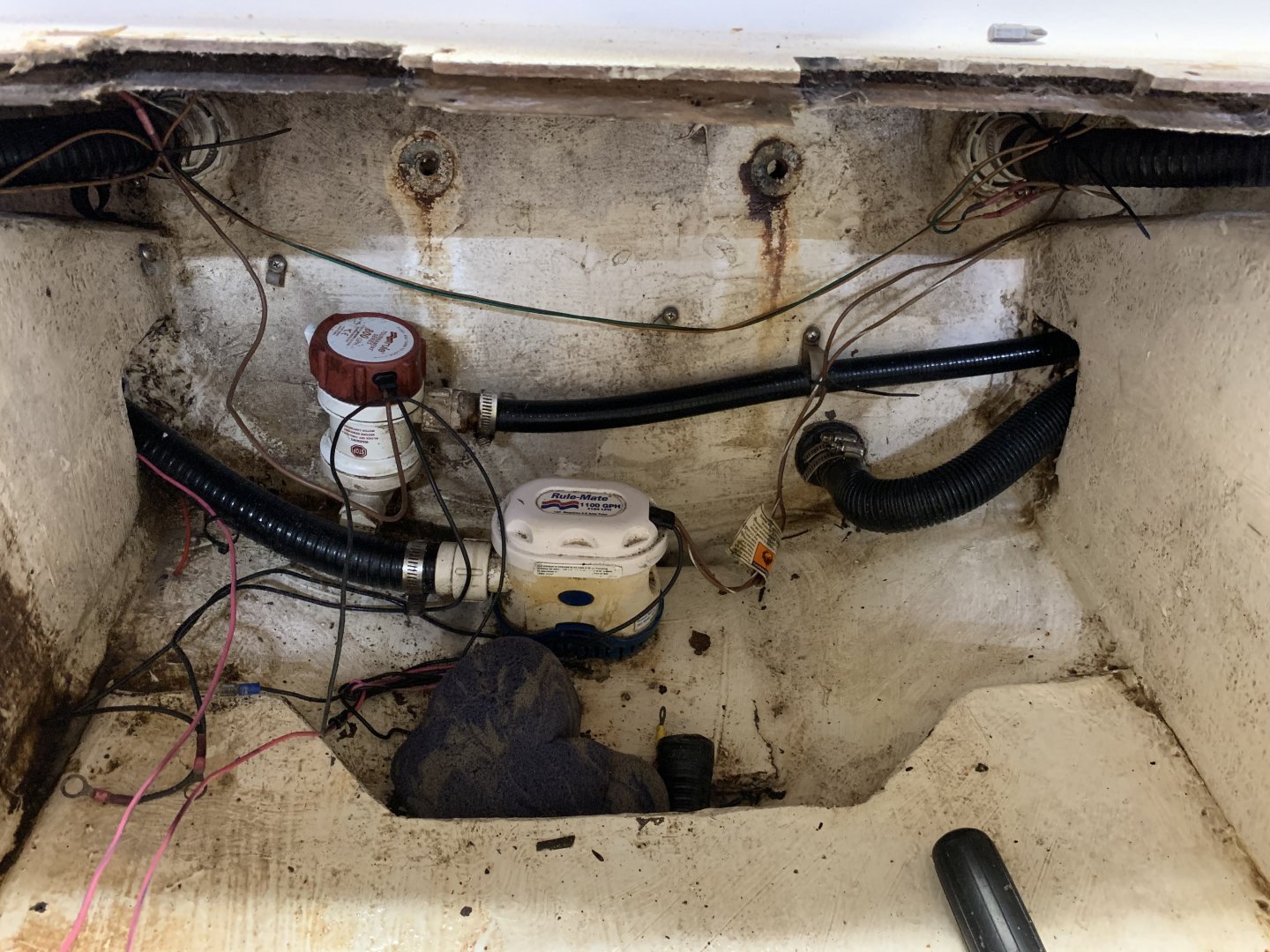

    Well I really screwed up. While I took a pretty good look over this project before buying it knowing it needed the deck replaced at a minimum I overlooked something so glaringly obvious that I’m truly embarrassed and ashamed! I got to cleaning out the bilge a bit and noticed that some ***** decided to cut squares out of the rear stringers where they meet the hull in order to route the bait well and bilge pump hoses through. Then at least they smeared plenty of 5200 against the transom. WTF?!?! The wood is exposed. It’s still firm but needless to say it’s pretty wet. I guess cutting out a section of these stringers and replacing is what’s required. I don’t know who’s the bigger *****, me or him. I was getting ready to order a new tank and start fabricating the deck. Man this sucks. I got about $3K left in my budget and I’m half tempted to give this project away and find a decent used hull to put on this trailer and slap the f115 it came with on there. The other part of me says I can do this. Wow, very frustrating.

    Pics
