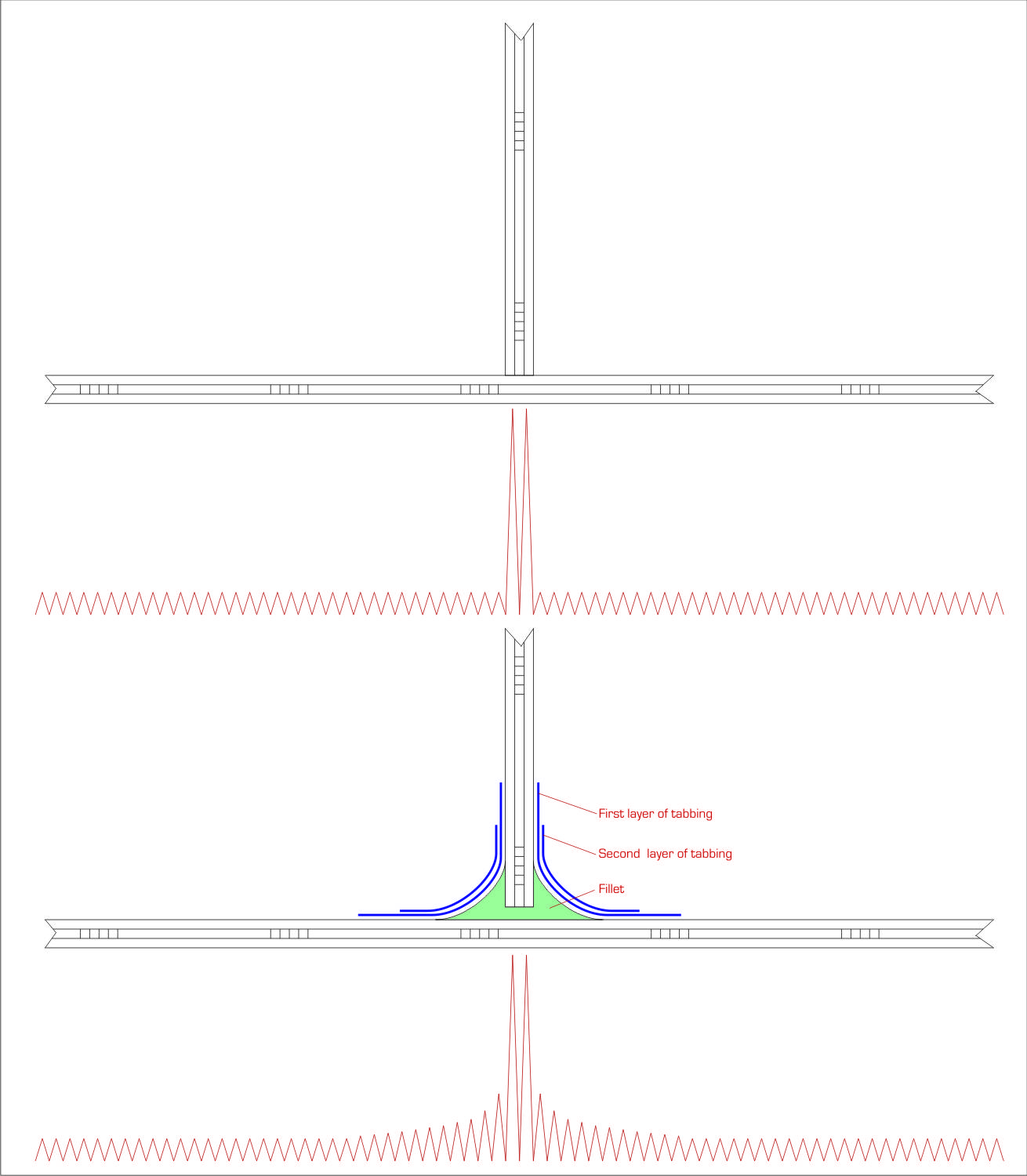

  8. PAR
    Joined: Nov 2003
    Posts: 19,126
    Location: Eustis, FL
    PAR Yacht Designer/Builder
    Wood flour is what Peter is referring and though I used to advocate it's use, I don't any more, unless is very fine flour and hardwood only. Sanding dust (regardless of the sander or grit paper on it) makes too big of particles. What happens is these larger particles, particularly softwoods suck up resin initially, but once the exotherm starts up, the resin tends to run out of the wood chips (thins with the heat increase), pooling at the bottom of the fillet. The end result is a resin rich bottom, with loosely held together wooden particles higher up in the fillet. Well ground wood flour is a much finer product and though it too can suffer this same fate, is less troublesome in this regard.
    For a bulkhead or partition standoff (as described above), just about anything will do, so long as it holds the piece off the hull shell and more importantly makes a neat radius for the tabbing to land on. The tabbing does the work and the standoff is just preventing a hard spot. Now, you're thinking, well if it's epoxy, shouldn't it be pretty hard, even with a filler? Yep, you'd be correct, but it's the tapering fillet that eases the load transmission through the opposing planes.
    Think of it this way, if you measure the density of the hull side (bottom, whatever) and inch along with your magic density meter, you'll have consistent readings, until you meet a structural element, where the density will dramatically jump up, because a perpendicular element is on the other side. This dramatic rise in density is where the loads will concentrate and cause a problem. If the perpendicular element is sitting in a tapered bed of fillet and tabbing, the density meter will see the density gradually rise, maxing out at the perpendicular element and then gradually decrease, as you move the meter farther down the panel. It's this gradual rise and fall of panel density, that will permit the loads to mitigate through, without undue spikes in load path choices, hence less issues. There will still be spikes in panel density, but they'll ramp up and down, instead of just suddenly appearing and disappearing.
    The sketch below shows the density changes. A dramatic change in density, will cause the part/element to break, just before or just after the huge density change.
