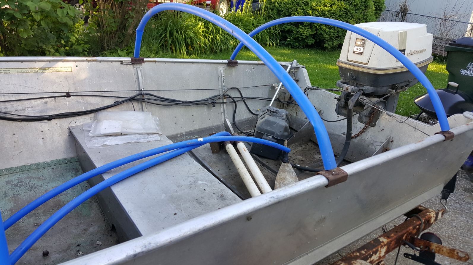

    So - I see an abundance of Orlando Clipper owners from - well - the Orlando area. I'm nowhere near there - Greetings from sunny, humid, Iowa! One of these beauties showed up here, would you believe!
    I just purchased for a song a new (to me) boat. It's an Orlando Clipper by name plate, and I believe it to be a 1956 model. The number stamped on the back is 56-14-1024 which I gather to mean that it was manufactured in 1956, is 14ft., and product number (serial #?) 1024. Is that correct?
    If that's the case, how do I find out what it's rated for as far as motor? The best I can figure out is that it's either 20hp or 50hp, based on whether it's a Zephyr or a Custom Zephyr. How would I know?
    My first steps are to power wash it and clean it out really well so I can see what I'm dealing with. I'm gathering that this boat has quite the following so my intent is going to be restoring to as close to original as possible. Any suggestions from someone who has done it before?
    It came with what I'm told is a 1969 Johnson 40hp motor (so I hope I have the Custom Zephyr! :confused: ) that I haven't tried to start yet, and that's one of my biggest concerns at this point.

    You can play with that antique motor if you want, but consider a newer model if it's in the budget. Boats of this type are simply valued, by their engine, electronics and controls. The boat and trailer are basically free, from a value point of view.
    The major concern with these hulls are the seam rivets, the floor rivets and the transom. It's probable the transom needs to be replaced, which isn't very difficult, but loose, leaking and broken rivets will drive you nuts searching them down and getting things sealed up tight again. Corrosion is another concern, particularly if fasteners were used that didn't get along well with aluminum or water.
    If you can provide the length of the boat and the max width of the transom, I can provide a reasonable guide to your maximum outboard size. Typically these were rated at 35 - 40 HP, which will make a lightly load one fly pretty good.
