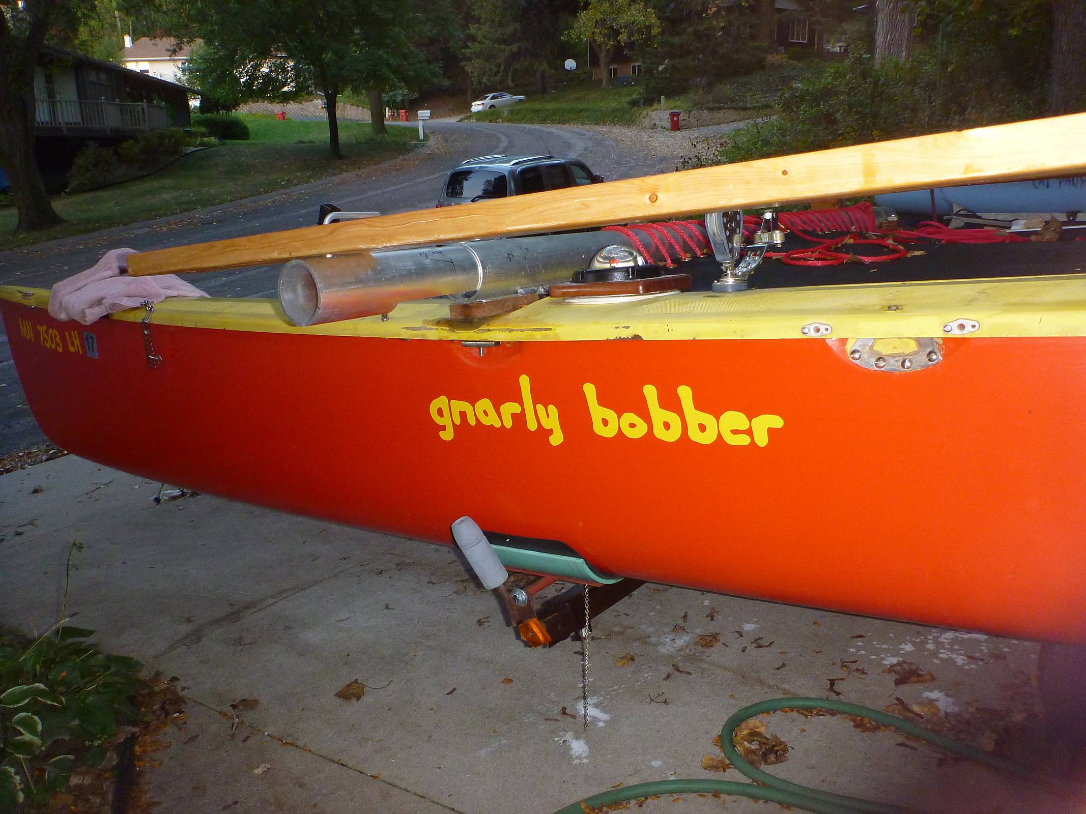

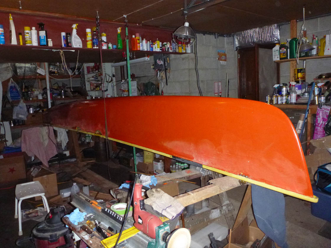

  6. BobBill
    Joined: Oct 2009
    Posts: 823
    Likes: 19, Points: 18, Legacy Rep: 157
    BobBill Senior Member
    Yes, welcome. Pardon my faux pas.
    Par, is a wealth of knowledge and helpful, as are some others here.
    I can only suggest what I have been doing with my hulls.
    I use the ipaint stuff, sans primer and it stick just fine. I was going to use house paint, but what I bought was water based and I decided thinning it was too complicated, so stuck with what I had from past year.
    Yes, 95% prep...
    I have been doing 3 coats. Seems to work and easier. I have thought about using an auto clearcoat and wax, for shine, but seems to be overkill to me...I refinished 76 hull (blue) and 83 hulls (red) and in service, seem just fine, to me. I have closer, in process, pics on other computer, but I think you will get idea. I am not racing, just sailing.
    BTW, I did not work on topsides, only hull bottoms.
    As to spraying. Works wonders, if you have the place to work etc. I do not, so I do the roll and tip application. Which ever you desire.
