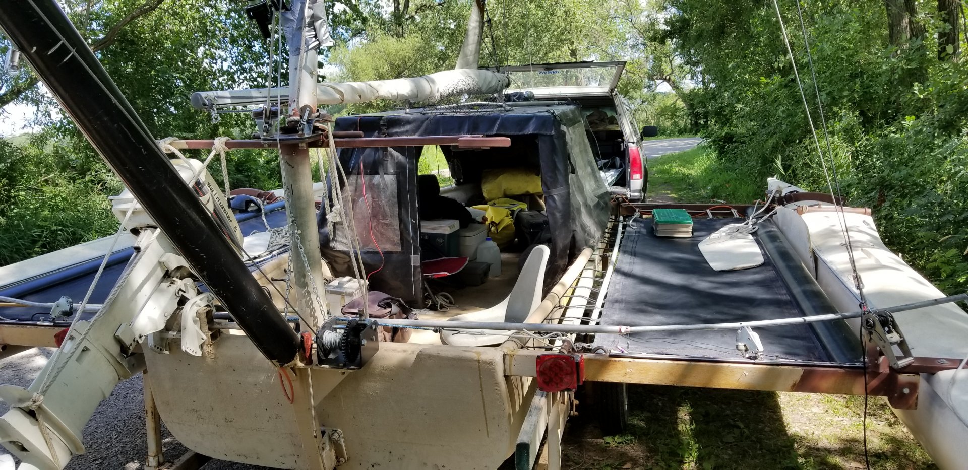

    Almost a fully equipped galley. I generally pack about 300 pounds of non essential gear.
    20170727_154645.jpg The inside will stay dry unless motoring into the wind. It uses 3m Velcro, and buckled straps.

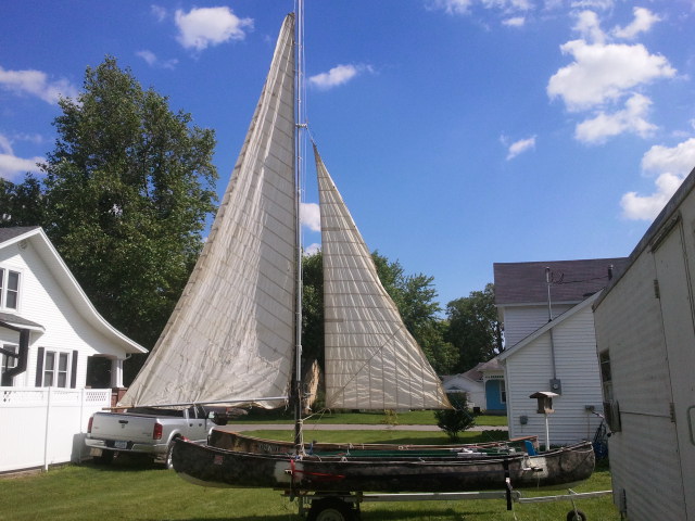

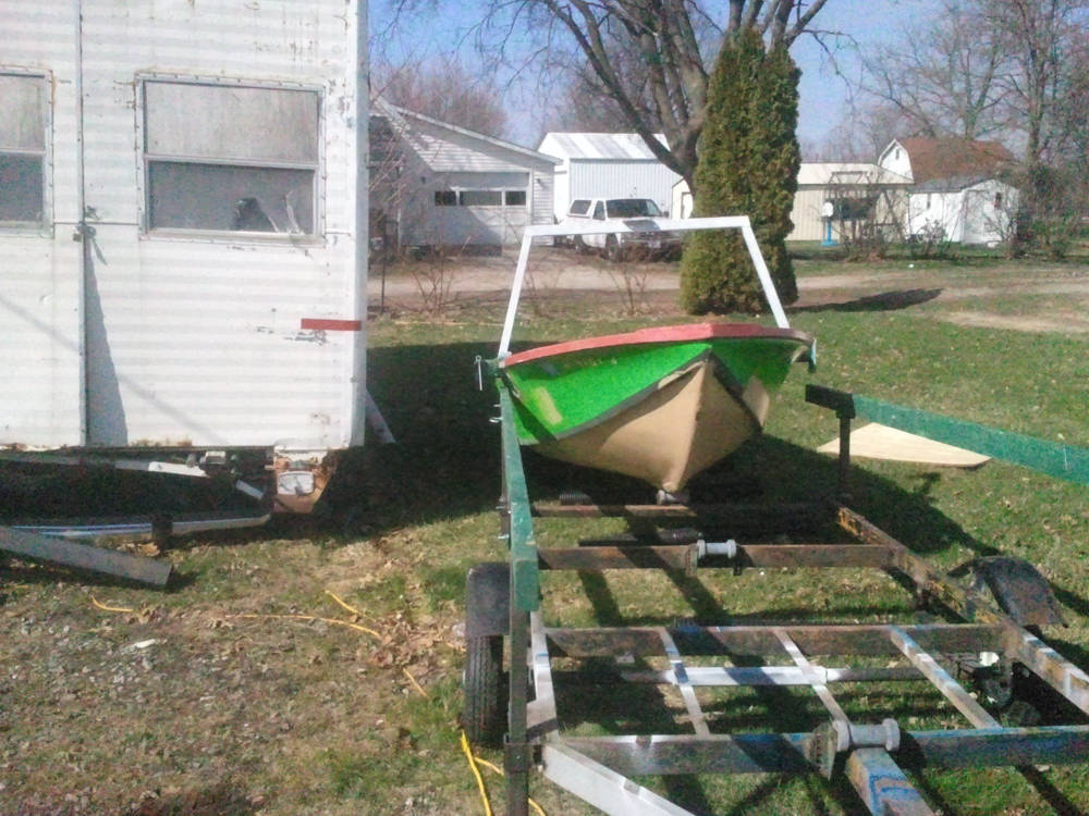

    Using the axles as saw horses, It is pretty light, 14 gauge steel.
    I used backing plates, were I welded the tubes that will support the ama crossmembers.
    Cut off the back 36" still need some 2" flat bar to reinforce the cross beams, that are rusted through, along the center bend.
    Need to add a toung extension, so I can launch with out getting my feet wet.

    Trailer painted, and slide under to fabricate standoffs, and set bunk boards.

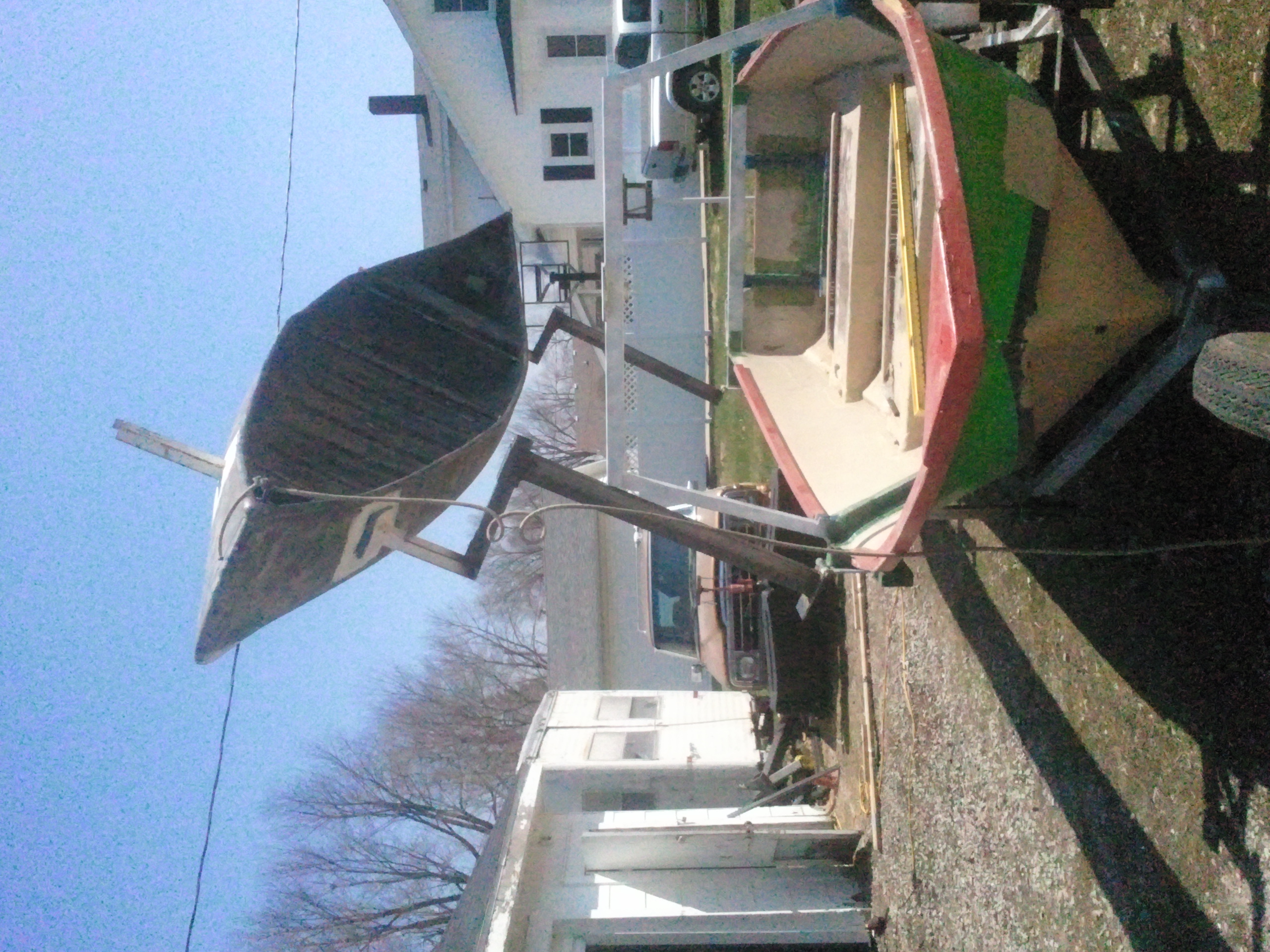

    Not sure what to call this apparatus. Standoff tube, maybe "cow catcher".
    If left about 6" above water when loading I can motor the trimaran and run it up on them.
    The tube will hold it in place, then a u bolt, locking pin will hopefully keep the boat from sliding back as I go up a steep boat ramp.
    The trailer has 4 standoffs, a 2x4 bolts in between them. It acts as a guide to line up on the trailer. I usually have to load up on the rough side of the lake. In a cross wind, it makes it a simple task.
