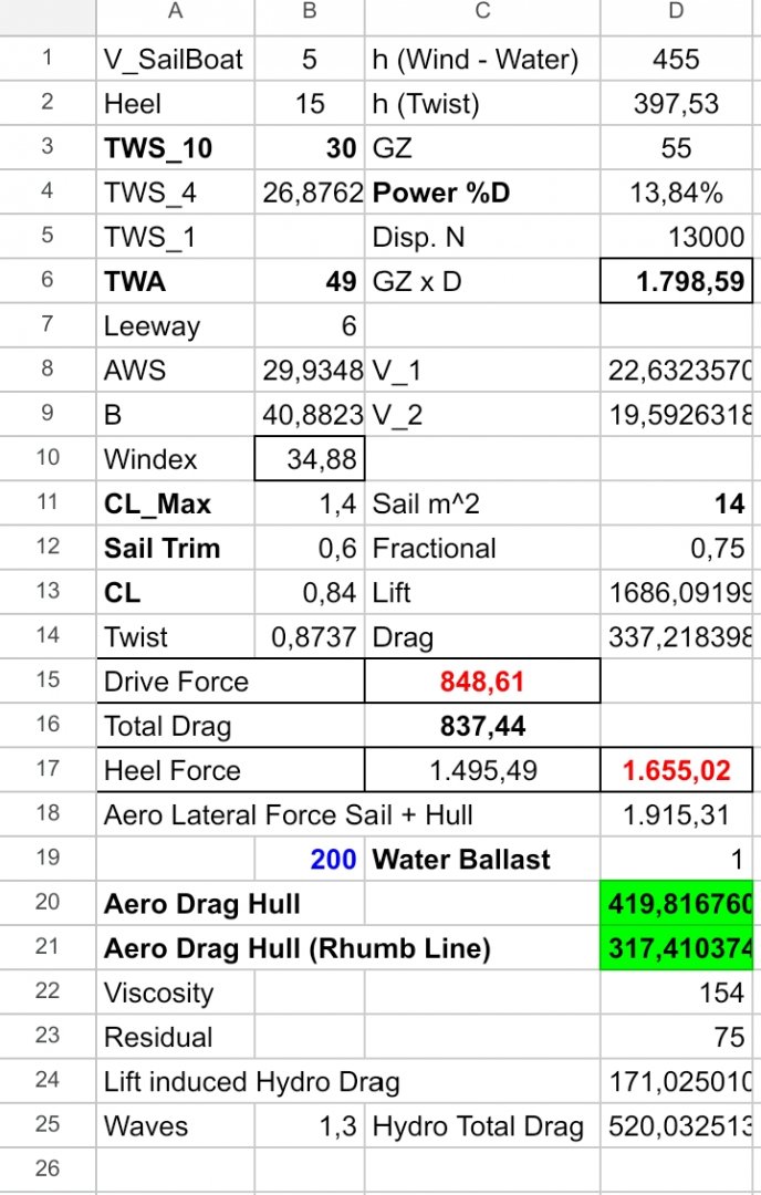

    Hey everyone,
    thank you John, for those links! I've read through 'The Design Ratios' ... definitely a good resource to have. Some things
    are clearer than in Elements of Yacht Design. I understand most of those
    The MIT Herreshoff Collection has filled many hours of my life already ... it's so awesome to be able to look over
    all these drawings in detail from home!
    I've now modelled three hulls in Maxsurf:
    A York 18 with a keel and ballast based on the Herreshoff 12 1/2
    A Welsford Pathfinder with optional water ballast
    And something in between - basically a York 18 with flat bottom and water ballast instead of the ballast keel.
    Then I was planning to calculate Equilibrium Conditions for all three with one crew sitting inside in the centre to get
    wetted area, displacement and prismatic coefficient for the light ship to compare.
    Then I would calculate the GZ curve to starboard with the crew on port to get max GZ and angle to then calculate
    the max Righting Moment. I would then calculate a max Sail Area from that at that angle.
    (and see how that compares to the designed SA for the Pathfinder and York 18)
    I'd then put all three models with that calculated Sail Area through the VPP for fun.
    Does that sound like it makes sense at all?
    Howlandwoodworks likes this.
