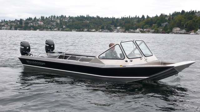

    This is the boat ? Twins very wide apart, must be near flat bottom aft, or the intakes would be out of the water.

    Something very similar to this Mr Efficiency. Very similar.
    Modifications include:
    Overall length shortened 2 feet
    Windshield and dash moved forward one foot
    Sidewall height increased 3 or 4 inches.
    And with the twin jets, they will be moved in closer to the center beam, and having two jet tunnels, the jet foot will be allowed to be raised up into the hull an inch or two (out of harms way) and the jet tunnels will force "clean" un-aggitated water into the jet intakes

    There is an inherent problem with a tunnel though it does help get the shoe up an inch or so.
    Assume the boat is running in a straight line, the transom is ventilated ie the water is coming off the bottom of the boat and if you look over the back you can see down to the bottom plate.
    The tunnel will be "full" of water.
    Then if you turn tight and left, the right side of the tunnel can become ventilated, ie the upstream leading edge and you can ventilate the pump, lose "grip" and control. The engine will over rev with the lack of load on the impellor until the boat slows down.
    If the shoe is below the bottom of the boat, without a tunnel this rarely happens.
    Of course slower turns will in most cases not cause this to happen.
    On the outboard jets that we built, we minimized this effect by welding on 1 1/2 inch strips to the shoe to increase the captured inlet area somewhat and it also provided a bit of a
    crash plate as these would bend and keep the shoe from cracking. Sorry, I looked and could not find any old pictures but perhaps it is something that can be found on the jet forums
    We also extended the tunnel back, then cut a partial circle into the top of the tunnel overhang to wrap slightly around the bottom of the pump. This reduced spray
    Again, sorry no pictures.
    The problem with the outboards jets is that when you go over a log or rock and the hull is lifted upwards, when you clear the rock at the transom, the boat drops and can hit directly on the shoe.
    Just some things to be aware of.
    If memory serves me right, our tunnels were about 24 inches long, from the transom to the leading edge, tapered up 1 1/2 to 2 inches. From the back of course it looks like an inverted channel.
    But the legs of the channel were at a 60 degree down angle from horizontal. The tunnel extension past the transom was a further 6 inches prox.
    On a narrow boat a tunnel will reduce some lift at the back and you might notice a nose high attitude as compared to say a regular outboard. With two tunnels, you will lose much more lift.
    The higher the nose, the deeper the transom, and you increase the draft somewhat. Going against the idea of a shallow running boat.
    I built a completely flat bottom 14 footer once and found that in rapids I would take some air into the pump and lose thrust. Additionally, the flat bottom was more prone to sliding
    on a tight turn. To reduce this, I welded on 4 2 per side 1 1/2 inch square tubing runners from the transom up maybe 2/3 rds of the length of the boat to give more directional
    stability. It worked quite well except for still taking in some air.
    A few years later, I did another, with a 6 degree V, gained better stability, used 1 inch solid runners for steering stability, and got rid of most of the air ingestion problems.
    If you do not really need the absolute minimum draft, I would not bother with tunnels, include some definite steering runners and use a 4 - 6 degree V
    Also, keep the beam as wide as you can at the chine. This is the easiest way to keep the boat higher in the water and carry some weight
    Thickness of the hull, 1/4 bottom, 1/8 inch sides. I would just look at the various manufacturers to see what they use. 1/4 seems like a lot for the bottom but if you go less, then you will need more stringers to strengthen the floor, which adds weight.
    Again, just look at boat that have been built from the major manufacturers as they often spec thicknesses etc.
