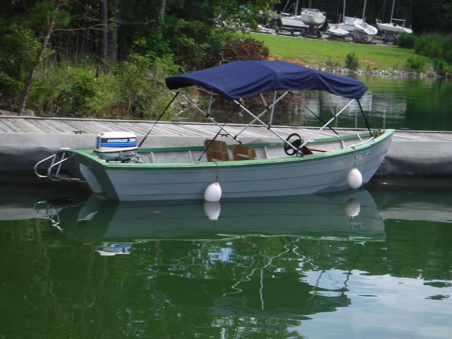

    Paul, If you get more interested in the Simmons, I can try to provide plenty of details. They were never "designed", just evolved. The original builder could turn out about one a week working by himself, but he had a wood shop and had developed patterns to work from. It is a simple boat with a low material count, but not nearly as simple as some of the stitch and glue designs. Total hull weight is under 400 lbs with a layer of glass so there really is not a lot of wood for a 17' boat. Also, there is no designer to help you with building issues, not the least of considerations. I don't think it should have anything more than a light center console and/or a modest bimini. It only has a 42" wide bottom so stability is limited, however, the narrow bottom also helps give it its performance. A 25 hp short shaft outboard is the suggested power, I have a long shaft 35 two stroke and it is probably a little too much. My boat will go over 30+ with two adults, it can carry a couple more but it gets crowded and slower. One or two adults is a proper load but it could carry a couple of smaller kids also.
    The boats have been in limited production since 1952, there have been kits and fiberglass production versions, and there are still models being built in wood and glass so they are well tested and respected.
