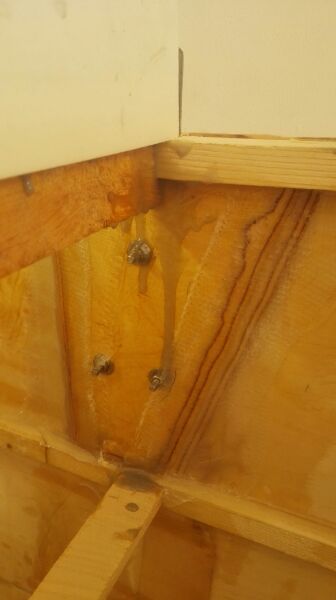

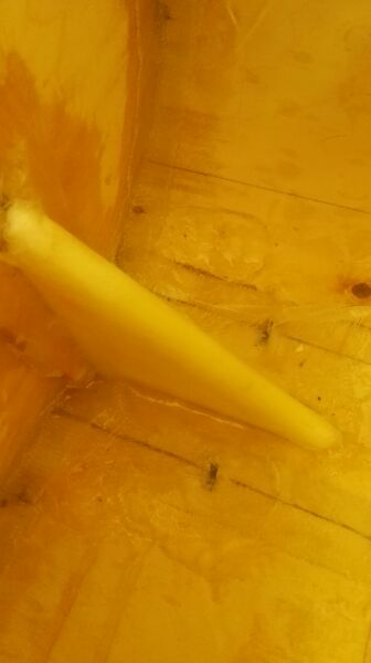

    It's about time for an update. The first (port) hull has all the stuff inside. Chainplates are made of 0,8mm stainless and laminated between 3 layers of plywood. Daggerboard boxes are 4mm ply with 12mm ply reinforcements. They are glued in with triangular wood strips to add surface area and held sideways by strips of wood. There's 7 foam semi bulkheads that we intend to cut to deck shape with a hot wire cutter.
