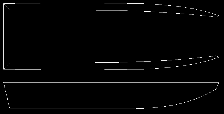

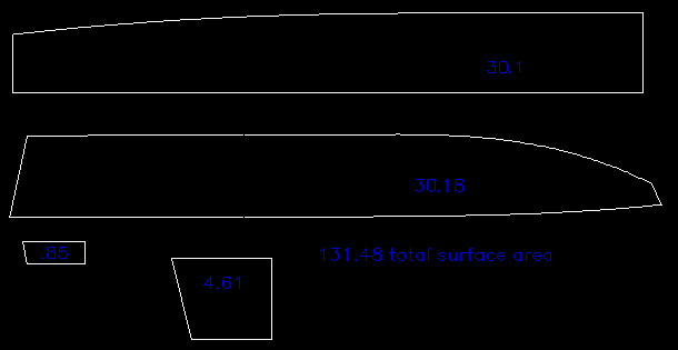

    yofish Previous Member
    So here we have your jonboat: 16' loa X 5' w X 2' h (4' w on the chines). The pics show lines, 3D view and plate developments with respective square footage per each. This a rough sketch that took all of 20 mins in ProSurf and is no way a finished plan but serves to give you some idea of the relationships between the elements you are dealing with. Get your charts out at work to calculate the various weights produced by each plate selection.
    for example: if using 1/8" AL plate = 227 lbs., 16 ga. steel = 328.7 lbs. I can't imagine making this out of material that is less than 1/16" (16 ga.) thick but I have no experience so what do I know? This does give you a perspective on what Tansl was getting at.
    You do not need to have anyone design a jonboat for you, you can do it yourself. They are about the simplest thing you could ever build; no naval architect needed.
