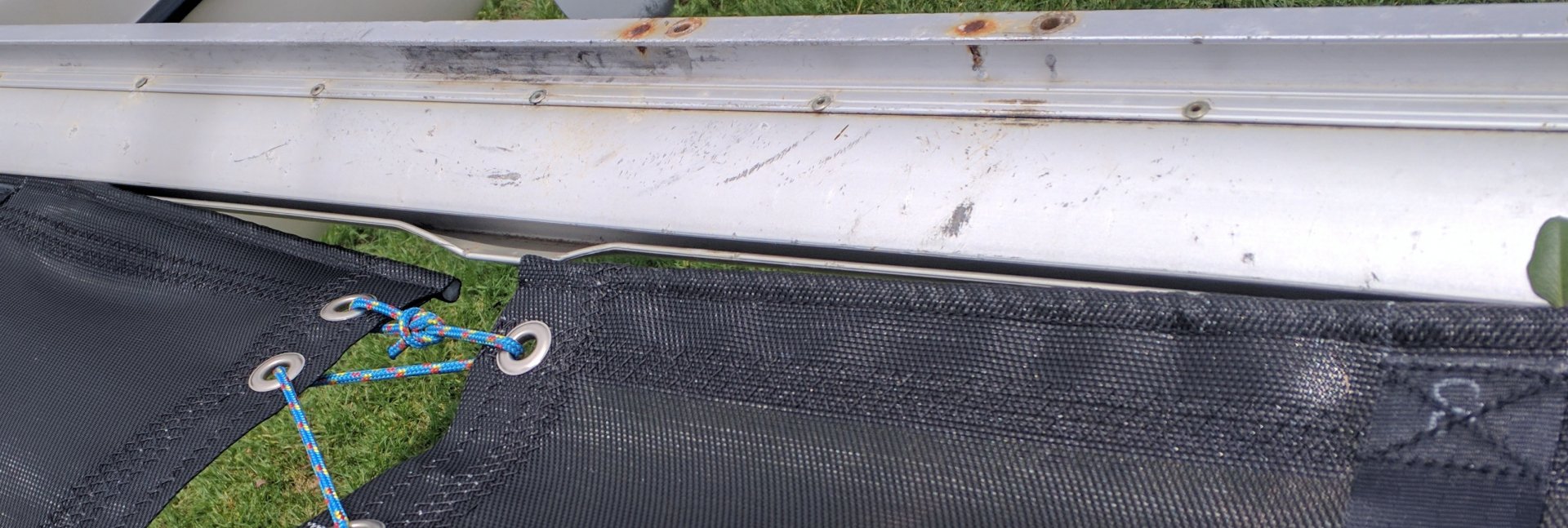

    Hi there,
    I got cheap little beach cat(caper cat 14) that I want to do up for my son, have been working thru it- rigging first and trampoline.
    I replaced the trampoline with a new one, nice and tight, then went to step the mast up- the bolt rope pulled at the center of the rear transom.
    Whats the fix for this???

    Welcome to the forum.
    A few questions as I'm not familiar with that design.
    Is the flair intended to be where the tramps are installed thru.? Or is there an alternate opening?
    Is other side of the aluminum clear? Or does stuff slide along it?
    Possible solutions
    Tight lashings from last grommet around aluminum.
    Cut off a bit of bolt rope so it is fully contained in unflaired aluminum.
    Crimp the aluminum flairing closed.

    Yes the flare allows it to be installed without removing the hulls.
    I am thinking about placing a sleeve onto the bolt rope in sections -cut the flat section off it or rivet it to the bottom flange slid inside of course- place it when I put the hulls back together so it has no flared out area as it does now.

    I have just pulled it apart- the trampoline has 10mm bolt rope, not 1/2" like the old one- back to the sail makers, no sailing this holiday.......

    Certainly take the picture to the sail maker. Might want to shorten the bolt rope as well as fattening it.
    Don't remove the slot. You will want to remove tramp without disassembling hulls.
    Restraining lashing wouldn't hurt. Cheap insurance.

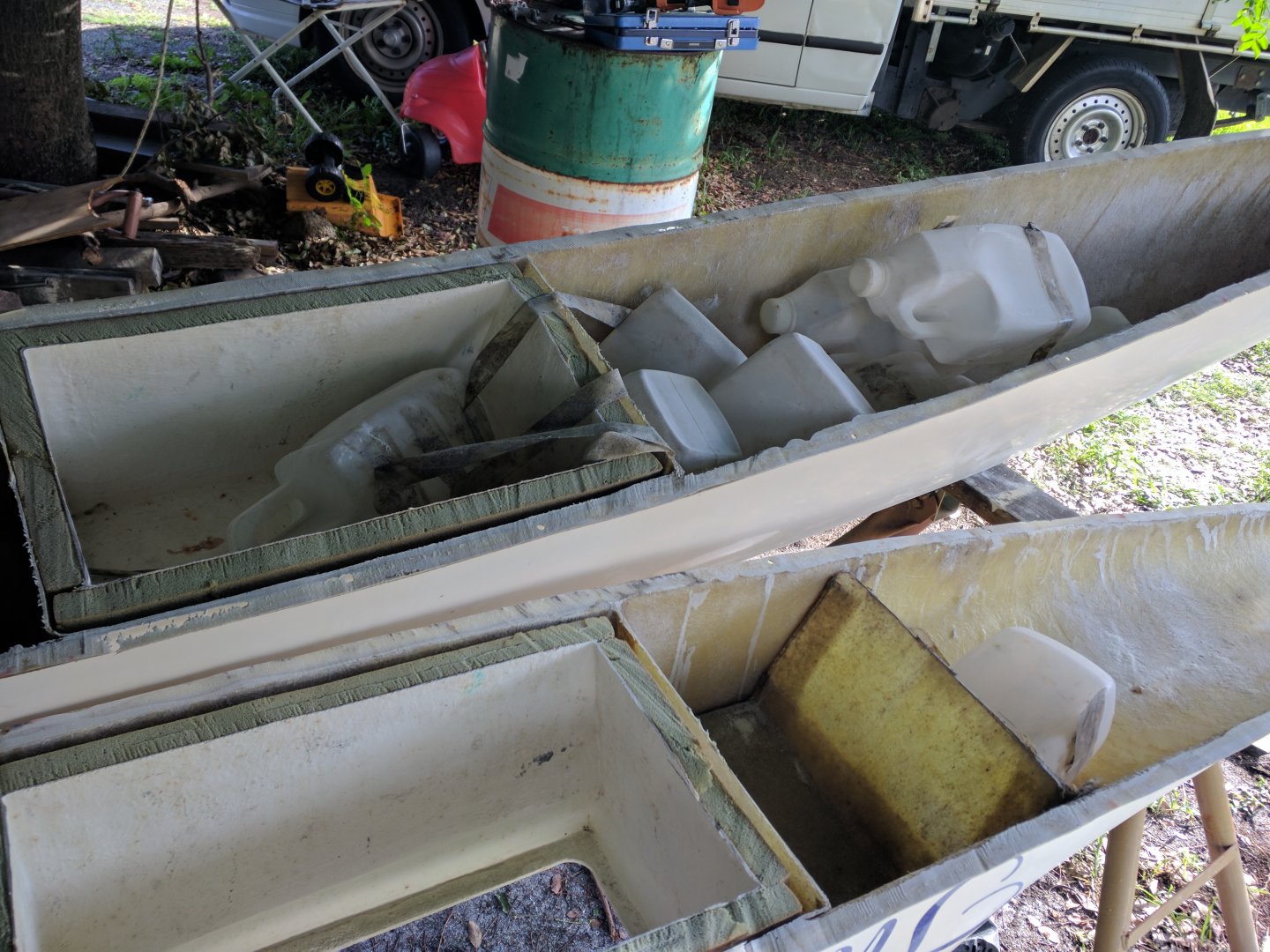

    makes me sick look at something that's poorly constructed- looks like 2layers of 225gm csm pe/resin, bunch of 3lt drink bottles for positive buoyancy! o_O
    no surprise when I peel it open(sent a message to the parts supplier, have you got the molds for these hulls? no reply)
    drinking beer in the sun, cutting fibreglass, listening to loud music annoying the neighbors.....

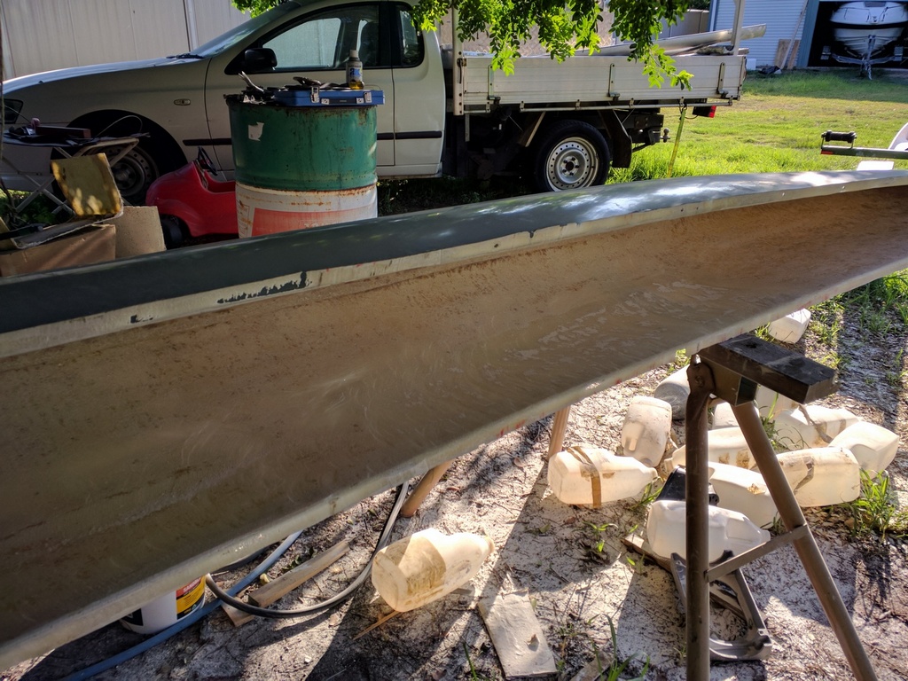

    If he doesn't reply I will give it a sand blast, 225csm with pe then s2 with 3;1 foam fill it(gp33), flick it over sand it off, quench the fibers, grind the weak spots, patch em with 450 csm and pe resin, fair it then gelcoat spray.
    Appreciate any input from real boat-builders, I am contract joiner by trade some of my powerboat buddies are shipwrights. This a whole new can of worms......:confused:
    I can imagine the shape of these hulls being seaworthy, but being like 3mm thick isn't making me think I go to sea in one I didn't re-engineer.
    No way I would let my kid go out on that sled of doom- bought it off a protestant pastor- said it was in fair condition....lying grub.

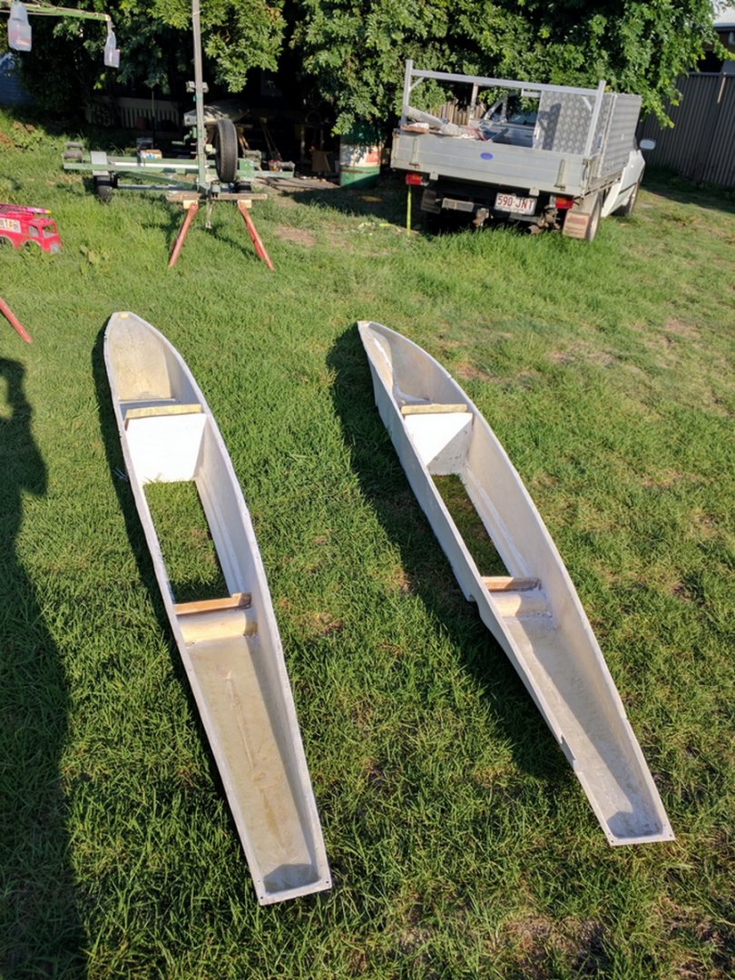

    hulls grinded up ready for layup

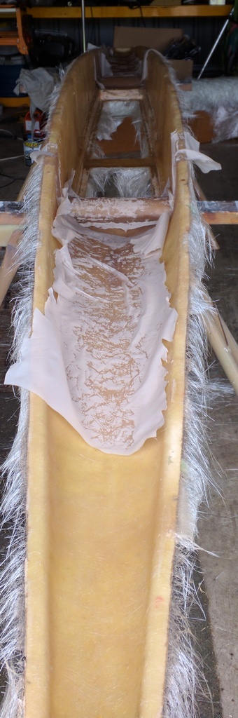

    First layup yesterday-
