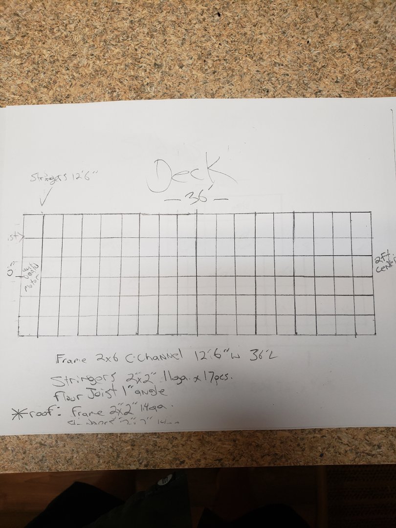

    Want to build a floating cabin nut I'm no expert and wanted to run it by you guys...
    What I have designed is:
    12'x36' frame of 2x6 c channel
    12' floor joists 2"x2" 11ga square tubing tied across with 1" angle iron to hold square.
    (5) 7' 2x2 11ga on each side to hold up the upper deck same as lower except perimeter being 2x2 rather than c channel.
    The reason for the steel superstructure is so there are no load bearing walls but also due to height restriction...the slip is 14'.5"
    And this is why I'm here....
    The cabin will be 28' front porch 6ft and rear 2ft 80" tall to accommodate a sliding door.
    I want a bedroom on top 12' so made centered atop the 28ft cabin.
    This will bring my height close to 14'
    My calculations show that in the end the floatation will be submerged close to halfway..so 12" and the deck will be pretty close to flush with the slip deck.
    I cannot find anyone to tell me is 2x2 11ga ok on 12' span? I've tried deflection calculators online but cant comprehend them intelligibly.
    I figure the bottom will be fine as they will be supported by 4' per side floats but the top may bounce....which I could compensate by walls for head and stateroom....not exactely loadbearing just bounce proofing.
    Next I think about it being 2ft taller than width...but only 12' so 1/3 total length and almost centered...dont want to tip over!
    It will be a cabin...not ever moving in the water.
    It will be clad in 3/4 ply so I think itll be sturdy but what do u guys think?

    This sounds like an interesting project - however it is difficult to try to visualise what you are proposing, without any drawings or sketches.
    I presume that you must have created some drawings so far - can you maybe post (some of) them on here please?
    Even if they are just sketches, 'a picture is worth a thousand words' of description.

    Ok I only have basic sketches. I suppose this may not be the correct forum for the steel part but I'm wondering about the width height issue...about 8 inches of floatation will be submerged...two sides 48" with 48" inbwtween so similar to pontoons. 12 ft width and 14ft tall... I feel like will be fine but want to be sure.

    I am a bit confused by the hull shapes shown in your sketches.
    The main deck appears to be 36' long, and 12' wide - ok, so far so good.
    I would be a bit worried though about the height being 14' - try doing a midship section sketch to scale, to see what it looks like.
    Especially as you appear to have a sort of 'transverse trimaran' hull form 36' wide and 12' long with three hulls - but these hulls are described as '4' x 8' x 24" ' - so are the pontoons actually only 8' wide, in relation to the overall width of 12'?
    If so, then you will definitely have a stability problem!
    I would be looking at a catamaran hull form, with two hulls each 36' long and 4' wide - this will give you twice the buoyancy of what your 'trimaran' sketch can provide , and much better stability.

    I won't entertain the hull designs. I was only trying to help you calc the 2x2 deflection.
    personally, my gut tells me you are overweight and the 3/4" wall sheathing means you haven't thought out weights and buoyancy well enough
    I don't have the required credentials to comment further here.

    Re your 6 'dock blocks', each 8' long x 4' wide x 2' deep, I think that you will need a lot more than this in order to get the necessary buoyancy for all the heavy superstructure and outfit equipment that you will be installing above them.
    Can you go up to 40' from 36' hull length?
    If so, then you could use 10 of these 'dock blocks' - that would be a 70% increase in the buoyancy available.
