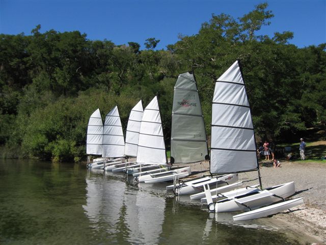

    Bazooka at 3.7 is 4" over 12' so apologies.
    22 are in New Zealand, 1 is in Fiji at a resort and at least 4 that are known of in Australia 2 being sold second hand recently.
    3 are in build presently.
    1 x Intro model, 1 x active model and 1 x excite model.
    Again apologies for being outside the 12' scope.
    Team Ezifold

    Thats ok. Can you post some more detailed specs? Looks good!
