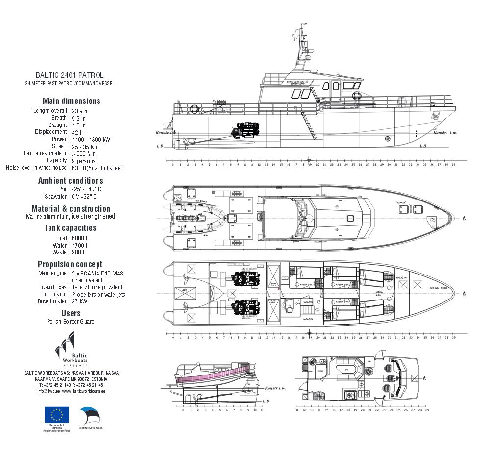

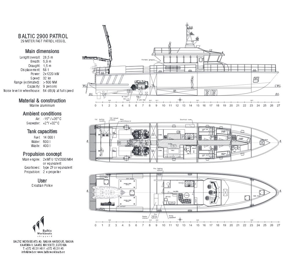

    The first step is as others have mentioned, you must develop a decent sized data base of comparables. Google long range patrol boats, coast guard cutters, crew boats, and motor yachts. Record all the data you can find, length, beam, draft, displacement light, fully loaded, GRT, power, fuel, speeds cruising and top, etc.
    Once you have some data points you can start to develop a weight factor. This will be length x beam x depth (main deck to keel) x w factor = displacement. Be careful about the consumable weights, best to separate them out. Once you figure out what your weight factor is you can estimate the weight of your projected vessel. Once you have the weight we can figure out power required and fuel consumption.
    Your GA does not have to float so don't worry about that, you just need a basic envelope. To do this in 2 weeks would be pushing it for someone with considerable experience and the database in hand. Your best bet will be to follow something already published. Think about centering heavier weights just aft of midships, and look at the volume required for the tankage.

    Can you guys give me an approximate total weight for the specs i have? Or otherwise tell me how i can get it?
  8. TANSL
    Joined: Sep 2011
    Posts: 8,002
    Location: Spain
    TANSL Senior Member
    It is very easy, just add the various items that make up the weight. Furthermore, if you calculate the moments about the coordinate axes, you'll also get the center of gravity of the whole.
