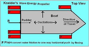

Drawing of demonstration show how a boat can move ,travel using flaps to convert oscilating wave energy to one-way horizontal push.

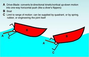

Boat in navigating , using material like (Diver's Palms) as means of propulsion . Flexible translicide. material
