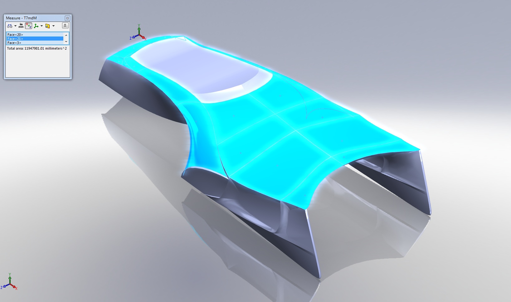

hull study for runabout with electric propulsion, maybe jet drive. highlighted areas meant to hold approximately 11 square meters of solar cell. not finalized.

      Hi, nice futuristic shape but the forward hulls apparently have no buoyancy. Too thin, no volume. Maybe it's just a matter of viewing angle.
    • DLK
      This was the stage, where the model could be transformed into solid body, since I have build this from surfaces. So this was the first time I could make cuts, to determine volumes.
      After that came "tuning" of the model, but even here, distribution of volume under water line is 50-50%, between forward hulls and main hull.
      When I started it, was meant to be a runabout with electric propulsion, so my purpose was to carry relatively great surface for solar panels, beside a minimal frontal surface in water, as well as smallest wetted area.
      This is why I made these wavepiercing planing hulls to the front, wich also carry some "features" to prevent water touching the whole side area of forward hull when it is effectively piercing wave.
      It was meant to be a light boat -around 900-1000 Kg with batteries- for relatively low speed -around 20-25 knotts- for the experience of a really smooth ride.
