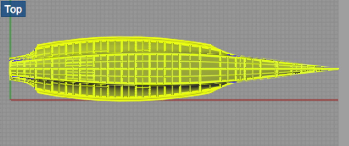

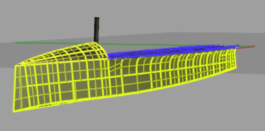

here are the pics of the SR-71 monofoil, it was designed to a design I've been working on for a 4 meter monofoil trap boat class (SR-71) , it will eventually have hiking wings and foils, but I'm still working on them.....
Loa - 4m
Beam At Chines - 38cm
Beam At Gunnels - 78cm
the boat is going to have a 60mm gantry, a trapeze, 10.75-11 sqm pocket luff sail, 2m wide rack and 7m mast w/ a 2.45m boom.........
