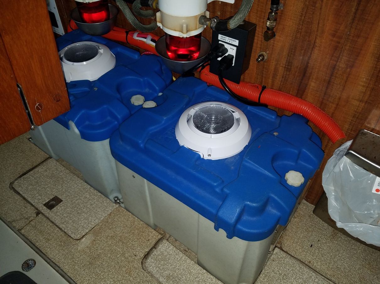

Nohona Mau: 200AH LiFePO Battery Banks
Here are two (O2) each 200AH battery banks installed in place Note the power connection form each bank to a 110VAC outlet for dockside charging via a Smart Charger mounted in each battery bank. The Power Receptacle is controlled by a timer so the charger cycles daily and only runs as required to keep pace with active dock-side loads. A reset (off/on) to the AC power is required daily to reset the Smart Charger which turns off after bank has reached Top Of Charge condition. My timer is set to run about an hour a day.
