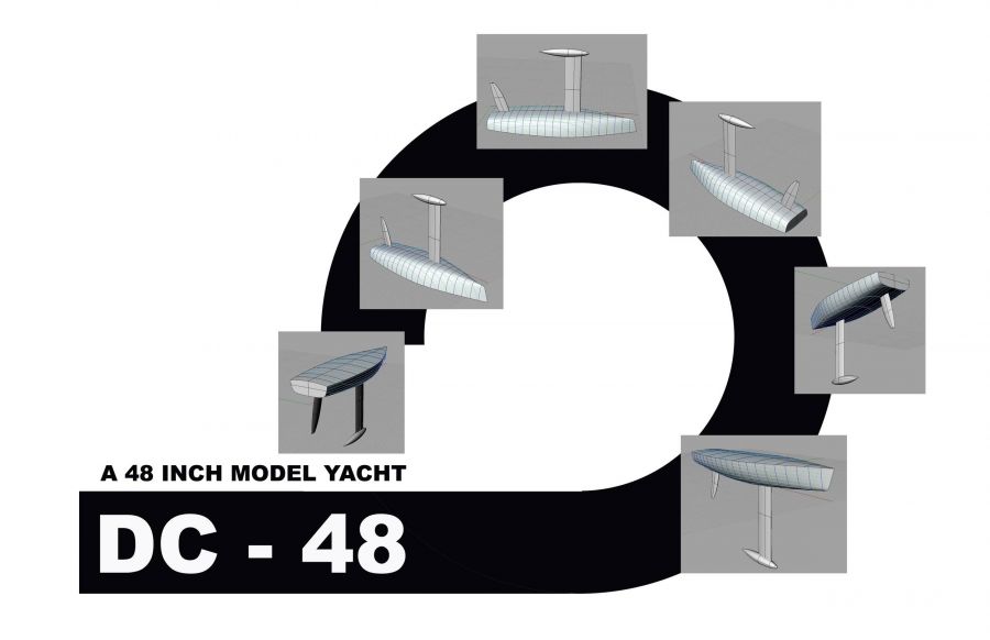

Hello...
A 48 inch LOA R/C model sailboat...
Would appreciate any of your thoughts...
SH.

Your keel is to far foreward, it is very likely to nosedive this way. Move it at least 1.5 sections back.
