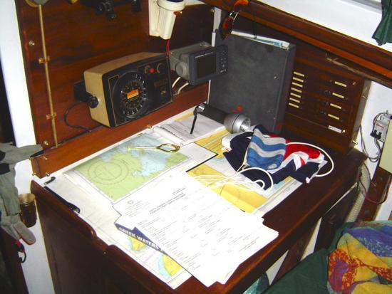

Detail pics after restoration.Original plywood deck was added a solid wood sheer strake for better hardware grip, rusted steel fastenings removed, new plywood scarfed in at fastenings rows sections, then deck reinforced by one layer Dynel set in epoxy.Finally painted with Epifanes antiskid.Cokpit and cabin as all deck clear coated mahogany , were re-varnished some 10 coats epifanes.
