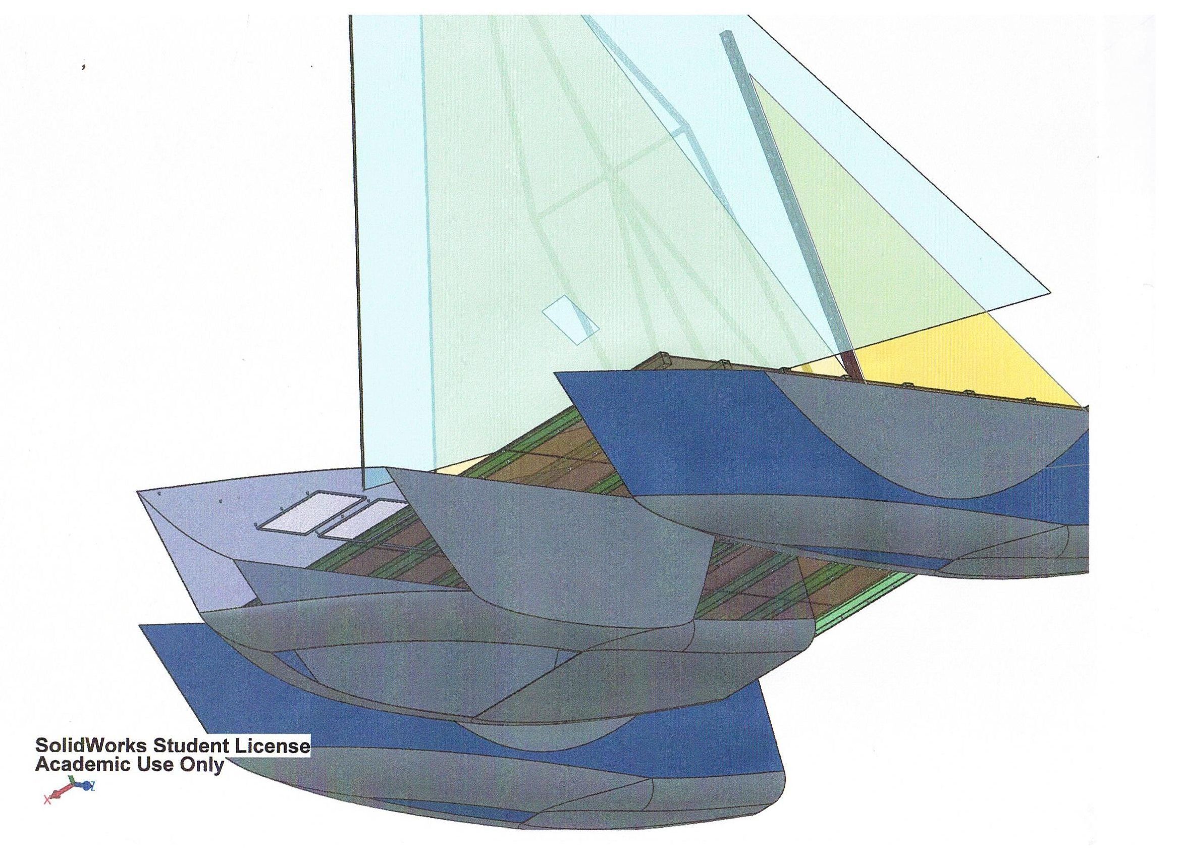

this is the Modular concept.

the hull is just a cat-hull which I widened to 8'(still trailerable, containable) for demonstration purposes.
Note that it is mounted slightly off-center and somewhat ahead of the 2 cat hulls to demonstrate the flexibility of the concept. Mix and match as needed.
Not all hulls would need to have motors, and could be special purpose(living quarters, water/fuel/blackwater storage, repair shop, cargo).
of course the plywood deck panels could be easily removed as needed.
this is not a lightly loaded cat design, or at least it has the ability for fairly heavy displacement if needed.
