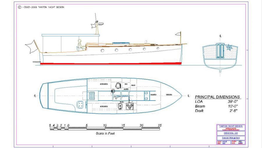

The radius chine hull is tailored for a plywood/cold moulded/strip plank construction.
While the raised deck forward greatly enhances facility in building, it also gives additional volume inside for a comfortable interior.
LOA 39'x LWL 38'x B. 10'x Draft 3'x Displ. 11400Lbs.

I like the basic concept: for the same materials, more internal volume.

The Gentleman's cruiser is designed for building with wood. With the possibility of FRP. construction.
As is often happens, the client had a change in mind. The project is now for a 40' aluminum chine boat, made for the Great Loop.
Keep posted.
