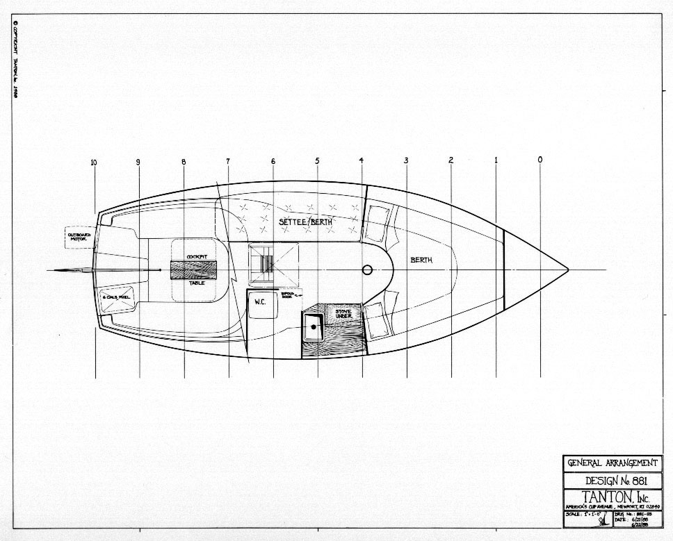

Accommodation Plan.
There is a V berth forward, which can be made into a double with a simple insert. On the port side is a single berth/sette;. there is no fixed table below, instead there is a cockpit table with storage beneath it. The head is situated immediatly to starboard at the bottom of the companionway steps, in easy reach of those that need it, with a bifold door for privacy (not something usually associated wit a 21-foot boat). Opposite the settee is a small sink and stove, with a cover that converts the stove area to a counter space.
