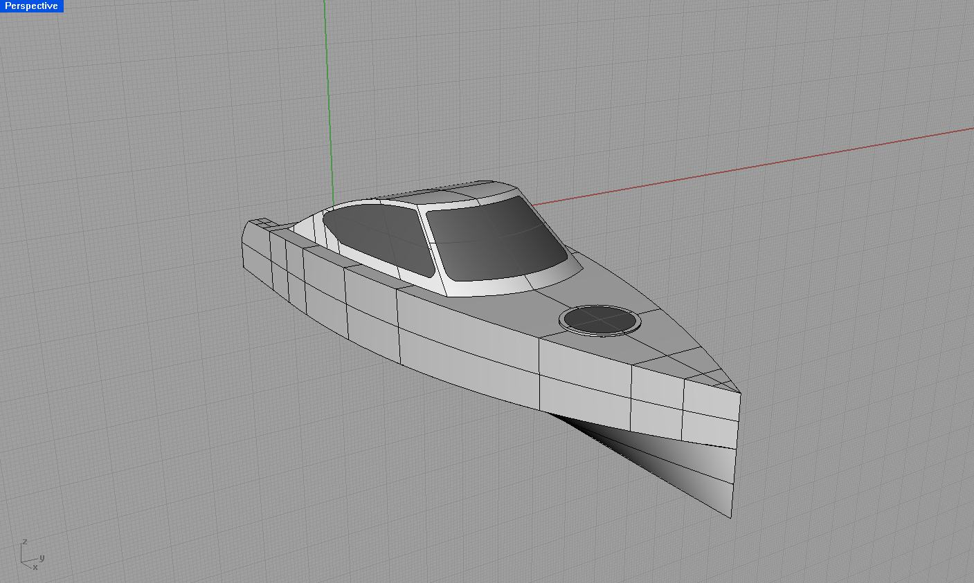

Hello...
Here is a Saturday morning of doodling...
I am starting to like it...
All developed...
SH.

Hello Sean, just one question. I can see an extremely deep V at the (near vertical) bow here. Don't you think it might create some serious steering troubles when navigating in following seas? That's what common seakeeping theories say.
Did you investigate into this before creating such an extreme hull shape?

Hello...
Per - Did you investigate into this before creating such an extreme hull shape? ...
Of course (k)not - that is a pun...
Just might play the opposite though - may release the forefoot a bit...
Busy with other things just now - porn - other media...
Thanks for having a look though - I will take your thoughts into consideration...
As I read my new WALLY - (Wally 118 and other) - book that my horrible wife bought me for my birthday - everything is way too sexy today...
Yeah - I know - pop the forefoot out before the stem - will investigate later...
Bow bites as the stern broaches - just when you need to pee...

"Bow bites as the stern broaches - just when you need to pee..."
Yeah, I see that you get the picture.
