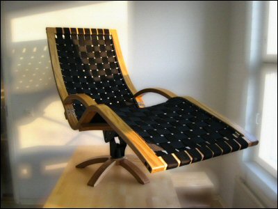

As I see it, a frame where the wood is closest to its natural shape, is the strongest (if the grain direction is respected). I have not tried steam pending but know the principle from craft school studies. Compared to gluelam it puts a lot more stress on the wood as the outer edge needs to stretch and the inner edge compress, how much is relative to the bend radius and thickness of the piece. In a same size gluelam you have thinner strips, so the stresses to one strip is a lot easier to the wood.
There are wood species that bend well with steam, in gluelam the woods properties don't matter that much. Gluelam has it's down sides, it needs a mold for every shape you want to make (there are many in a boat).You also need a good glue and enough clamping pressure for the glue to work. Steaming needs a mold if the shape of the boat cannot be used.
I have made radiuses as small as 200mm (8'') in oak/birch with gluelam, the piece was 30x60mm and bend the 'easy' way. That piece was made of 2,5mm strips, 12 strips to make the complete laminate. I have serious doubts that could be made with steam pending.
This is the finished chair, the tightest radius is at the seat and backrest transition.
As for sawn frames, I'd say it falls between the above two, if straight pieces can be used and are joined with adequate gussets. Sawn frames is probably the easiest if the techniques.
Hope this helps someone.
