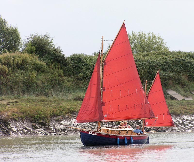

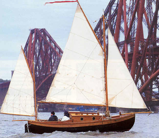

Iain Oughtred's Eun Mara...around 1/2 the length you were looking at but a more realistic build in the time you have stated...They always take longer than you estimate
woodenboat forum topic on it.
http://forum.woodenboat.com/showthre...-Mara-pictures.
