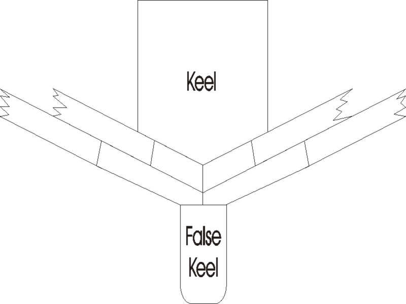

You guys are amazing - where do you dig this stuff up from!?!....I'm going to have to do some serious library building....
Will - I'd like to see the rabbett drawing if it's not too much trouble.

Have seen this done on a large power boat. The false keel was fitted to a planed landing on the second layer after the goo set up. No rabbets anywhere . . .
