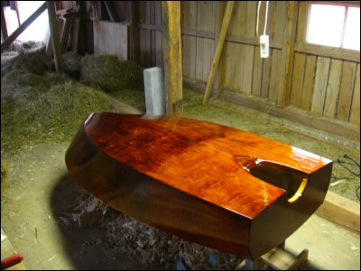

Thank you Apex, I sure hope it does.
This pic shows the difference a bit better.
BTW, I have to sometimes question my own logic in choosing tools for a job, yesterday I faired the bottom plywood panels to the side. For the first side I used a handplane and about half an hour of pretty hard work. Just before bow I gave up and switched to an angle grinder to see how it would do. The other side was done under five minutes and with fewer marks to the remaining ply. Random orbital sander took care of what was left. A handplane is a good tool, I made all the pre-gluein fittings with one (bottom panels are butted at the stem/keel, not overlapped), but taking out a lot of material is a job for powertools.
