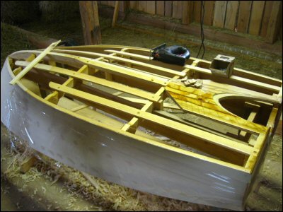

    Hello

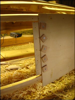

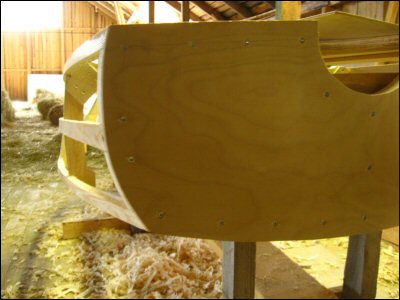

    The first side panel was glued a couple of days ago. The 4 mm ply took to the stern tumblehome twist a lot easier than I had thought, but I should have trimmed the excess of the ply before glueing. I have a feeling it's gonna be a ***** to fair later on.

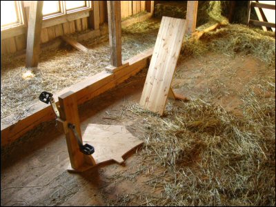

    Pics, testing the placing of cranks and seat...
    ...glued transom...
    ...and the first side panel.
    I went shopping yesterday, now I have most of the materials at hand. The stain I have to buy next time, I'm going to need it soon. The angle gear provided me a good challence, the bevel gear cogs alone would have cost nearly 80 €. I solved that by doing what others have, bought an angle grinder. It has an aluminium cased angle gear with 1:4 gearing (or near that) and cost me only 20 €.
    I also got some deck hardware, a nice looking cleat to the bow and a couple of attachment rings (U-shape welded to a plate) for the stern end. I'll take pics of those later.

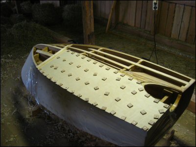

    Hello
    No, I'm not dead yet, just been too darn busy with everything else. The missus moved in. :p

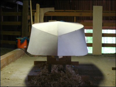

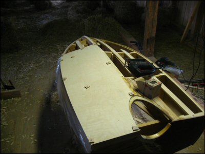

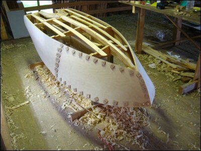

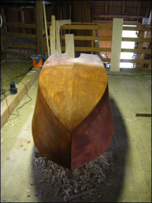

    I got a little something done in the last couple of days, two more pieces of side plywood are glued on, one piece still to glue and the sides are ready for finishing. I cut the extra off the pieces before glueing to ease the fairing later on. That also made the bending easier. I got the transom sanded, stained and the first coat of polyester on top. I also coated the frames in the places that are hard to get to after the plywood is on.

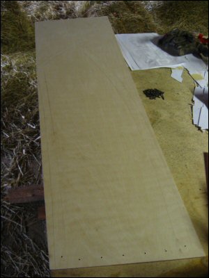

    I marked the chine and sheer (and side batten) to the inside of the plywood on the first fitting and drilled the screw holes from that side. This way I get the holes in nice straight line and all the pencil marks are hidden inside. Also in the pic can be seen that I cut the joining face at a slight angle to better fit to the curve on the bow.
    Gusset to join the two side panels.

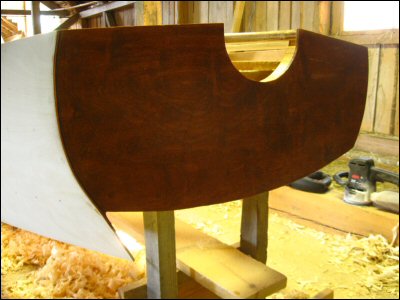

    The transom in colour.
    First ply panel on the port side
    I think I screwed up with the side battens, they should have ended about half way between frames #1 and #2 instead of forward of frame #2. Now I have a flattish area on the side around frame #2. It remains to be seen how bad it actually is, but I know it would have looked better with shorter battens. This also resulted in the joining faces of the side ply panels not to fit. I had to plane the joining face of the bow panel a bit concave.
    Well, that's all for tonight.

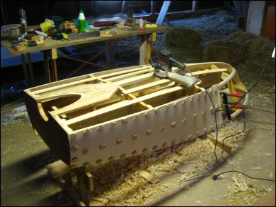

    Hello

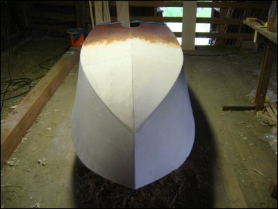

    Time for some update. I've actually got a lot done since last update.

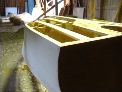

    Last of the side panels glued
    Fairing before bottom panels

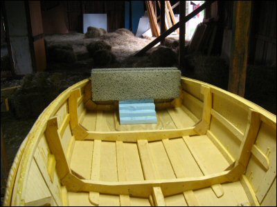

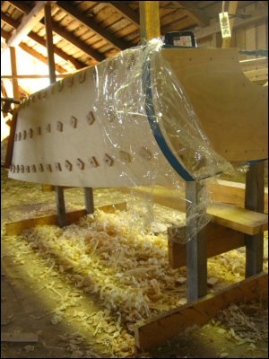

    And fitting the first bottom panel. Second fitting in progress, I drill thru the holes in the ply to the framing underneath and attach screws where needed to bend the ply in shape.
    Glue applied to the framing and masking done to protect the wood from glue runs.
    And first bottom panel screwed on and waiting for the glue to dry.
    Glueing some foam pieces to make the tunnel mold.

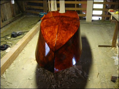

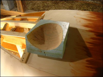

    I clamped the foam block in place and used the angle grinder to form the tunnel shape to the boat bottom and the foam at the same time. This pic is after painting the mold with PVAc-glue and some wood putty for fairing.

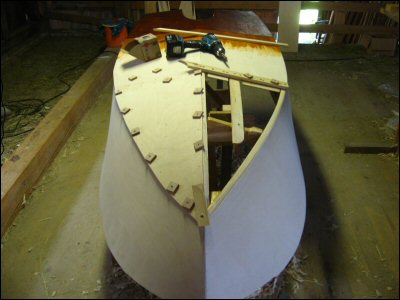

    I had a bit of misfortune as the ply sheet I had thought I could use for the last two panels to the bow turned out to be a lot thicker than it should have been. It took me a while to get a new piece of ply. I think the pieces are from the same pack as the original sheet as it has quite similar pattern, just the wave is missing. Good thing is, the thicker ply also was of poor finnish so I'm happy I got some new ply. Here's the second to last panel.
    Last piece glued and fairing complete. Just some holes to fill and then the stain.

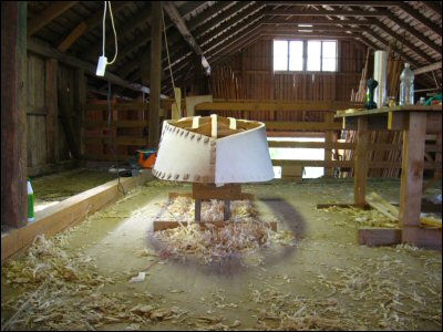

    Stained
    I had thought I could save some time and had stained and coated the aft end of the hull earlier so I could start making the tunnel. Of course the stain didn't match the earlier one. I think the reason is I used the same foam(suberlon) piece as before and I should have cut a new one. The newer stained area is a bit darker. Oh well, I'll see what I can do to it, I have a couple of ideas. :) I'll take the hull to direct sun light tomorrow and see how bad a mess I have made with the stain.
    Anyway, here's the hull with first resin coat on, the lighter colour can be seen in the aft.
    Darn, that was a long one, I should do this more often. :p
