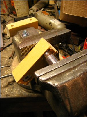

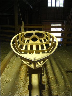

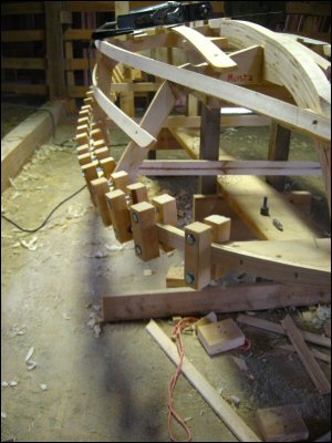

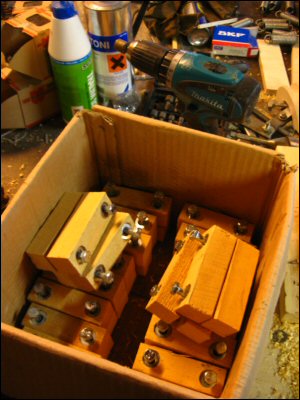

Hello

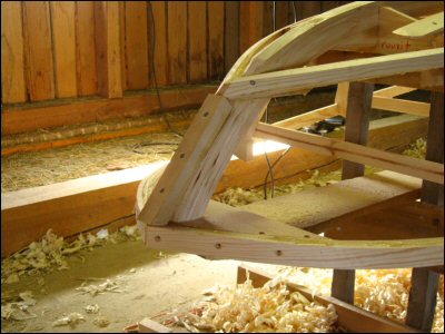

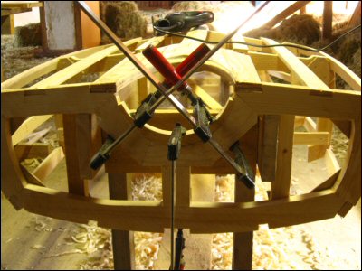

Got some small things done on the boat again today. I solved the lack of clamps by making my own. I already had all the parts needed so I just needed to cut the wood blocks and assemble the clamps. I took some poor quality (knots and twists) 32x32 mm (1 1/4'') timber and cut it in 100 mm pieces (got rid of the knots ), all 40 of them. Then I bored 10 mm holes through and 22 mm holes about 5 mm deep for the nut and bolt heads. I pressed M8 punch nuts in half of the blocks and assembled the clamps with M8x70 half thread bolts. I think they cost me under 10 euros for the 20 clamps.
Of course they had to be tested so I glued the second layer on the chine on one side. The cordless drill is a perfect tool for tightening the clamps, I only used 5/16 torque setting in my Makita. Temperatures are again on the low side, so I'm not sure if one day is enough for the glue to dry, we'll see.
Making the clamps
All 20 clamps done
And the second layer of chine
I am also finalizing the plan for the prop, so I'll also start making that in the near future. I originally thought of using 6061 aluminium for the blades but I'm not so sure anymore. I don't have tools or experience for welding alu so if I end up making a solid prop instead of a folding one, I probably have to change the material.
Lurvio

TeddyDiver
The bottom doesn't have convex/concave shapes so it is the easy part. The tunnel part does need a fabric that forms easily as it has pretty much all the troublesome shapes possible.
hoytedow
Thanks, they work well after I realised I only had to open one of the bolts to get it over the chine.

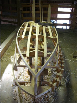

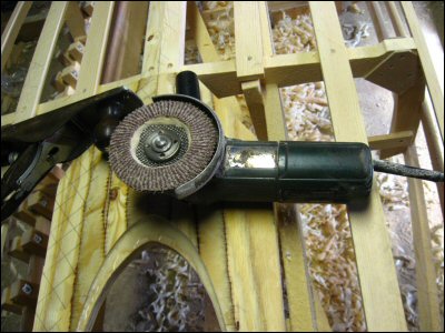

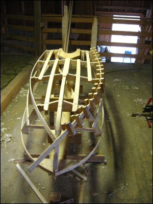

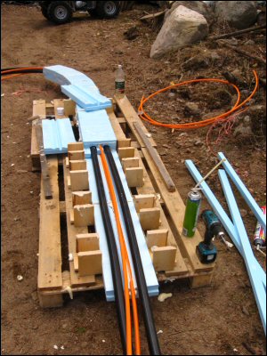

Hello

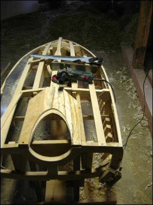

I've got a bunch of work done since last update. The sheers and chines are glued and the bottom faired. Also made the first major mistake.
This is the 'dayjob', glueing styrofoam pieces around plastic waterpipes. That's the heating pipe that'll connect the boiler house to my workshop. Big pipes (black) are for heating water and the smaller ones (orange) for the hot water (left dry at this point).
Gluing the sheer, layer #2. All 20 clamps in use.
And layer #3, I started the last layer from the frame #1 forward because the stern end already had the shape needed. I clamped the last layer a bit more loosely (clamps further apart), so I could do both sides at once and save a day of waiting. Turned out okay.

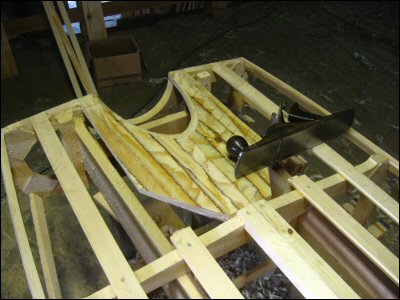

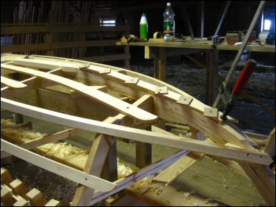

Starting the fairing, the angle grinder with 40-grit sanding disc made short work of the plywood. I had to take about 15 mm off the sides and one 3mm ply off the center.
Looking good so far

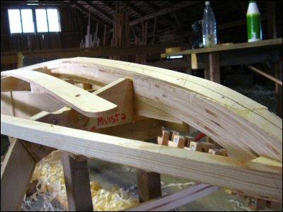

And then the mistake. When I originally attached the bottom battens, I had to make notches to frame #3, turns out I made them a bit too deep. So when I used the chine and the batten as a guide in fairing the stem, I planed out too much and made a flat spot. The battens weren't glued yet so I added 2 mm shims under the problem spots and glued the battens in place. I glued a leftover piece of chine veneer to the stem, waited over night and tried again. Turned out good enough.
Patch glued on...
...and re-faired. The piece of tape has the word 'Muista' on it, and 'ruuvit' on the other side of the stem. Remember the screws.
Fairing the other side, the grid is pencil lines to keep track where I had planed.
The sanding disk I used in the angle grinder, 40-grit. And the hand plane of course.
I have been thinking about the prop tunnel and finally reached a conclusion, I am going to drop the prop a bit lower in the water, 2 cm should be enough. I made a piece to modify the tunnel shape in the transom and glued it on.
Also the stem between sheer and chine needed some extra wood so I faired a spot and glued a block to it.
Next time fairing the sides and then I have to start making the cardboard patterns for plywood panels. I found a supplier for the fiberglass and resins nearer than I thought, I have actually bought something from them some years ago. The guy suggested IŽd use 450 g fiber mat and on top of that fiber cloth on the boat bottom. Seems overkill to me, what do you guys think?
And then a question I've been pondering, what panel comes first? I think transom first, then the sides and last the bottom, is that right?.
I think I had yet another question, but I forgot it.
Lurvio

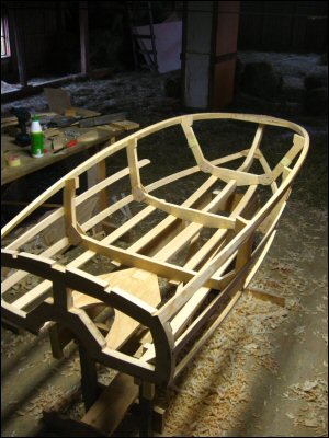

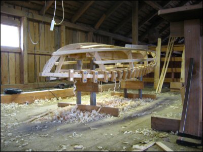

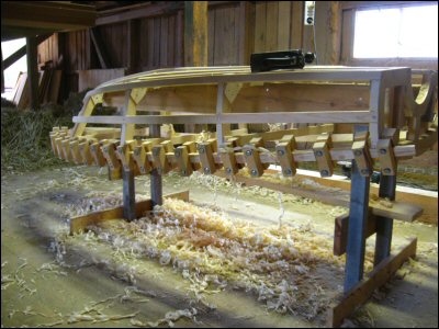

Hello

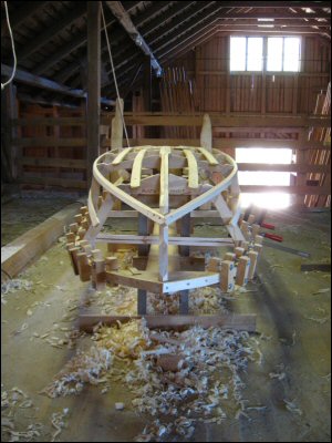

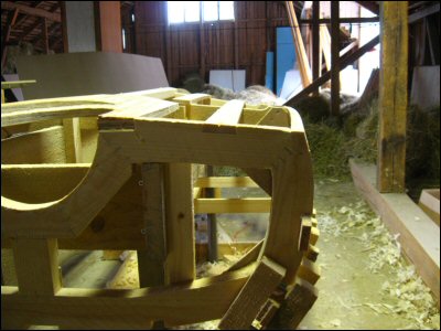

Got a couple of hours on the boat today and faired the sides. Turned out to be a bit easier than I had thought. Then I removed the screws that held the frame to the building form and pried the frame off the form. It was well stuck in a couple of places due to glue running to wrong places. I took the frame off the form for two reasons, I wanted to see the fairing of the sides from a better angle and I also wanted to weight the frame alone.
I should have good chances to keep the boat well under 50 kg, the frame weights exactly 10 kg. Deck framing will probably add 1 kg when done.
And some pics.
Lurvio
