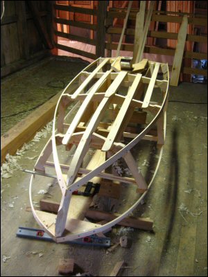

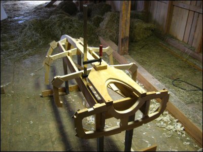

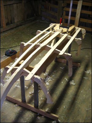

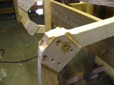

Hello
I got a full day of work on the boat today. I cleaned the excess glue around the gussets and reattached the frames to the building form. Then I screwed and glued the keel pieces (2) and the stem* on to the frames.
*I did some studying on the terminology, GlenL Glossary.
Keel & stem attached
The gussets faired. A jigsaw was real handy in this.
I also got the bottom battens made and attached.
And the breast hooks glued from two layers of 15mm ply.
I cut the breast hook pieces from different sides of the plywood piece, so the surface veneers are diagonal when glued. I don't know if it helps much, but it looks better.
Now a bit of a problem, how do I attach the lower hook sides? The top is easily screwed to the end of the stem, but the lower hook is in two pieces both sides of the stem. I could bore long holes from the side and screw it in that way, but if you have ideas, they are very welcome.

It is taking shape nicely and the woodwork looks to be very fine quality.

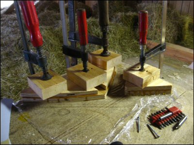

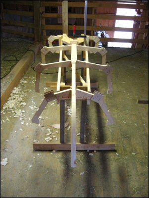

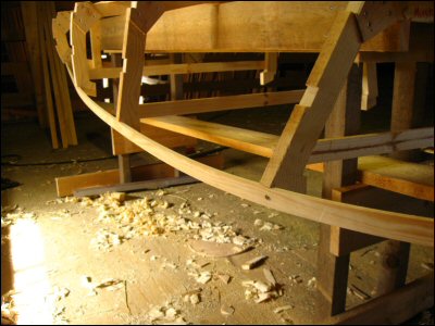

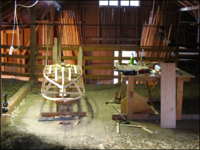

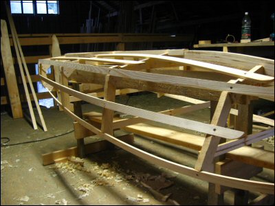

A little update
I got some work done on the boat again today. The weather has also warmed up a bit so the glue works a lot better.
Yesterday I attached the breasthook and the lower hook. Today I faired them to the final shape. The lower hook was a real pain, I had made it a bit over sized and had to remove more than half the material to get the final shape. The jigsaw again saved me from a lot of trouble. Then I faired the frame notches to their final shape and got the first layer of sheer and chine, and the side battens attached.
The boat is taking shape and I think it'll be something to be proud of in the end. I spent some time on the barn floor lying on some hay and just stared at the thing.
Well, on to the pics then.
Next I need either to buy a bunch of clamps or make my own. Wooden clamps for gluing the sheer and chine layers are very simple in structure and I probably have everything needed at home. If I find big spring clamps at a reasonable price somewhere, those would also work.
Probably won't get anything on the boat done tomorrow, there's an excavator coming to make a trench for the heating pipes connecting the boiler center to my woorworking shop. And then I get to play with urethane foam making the heating canal.
Lurvio

  #30
Old 04-25-2010, 06:20 PM
ancient kayaker ancient kayaker is offline
aka Terry Haines
Join Date: Aug 2006
Rep: 1682 Posts: 2,818
Location: Alliston, Ontario, Canada
Just in case you don't know about this, you can make a pile of spring clamps in a few minutes for pennies from plastic plumbing tubing: cut a slit along the length then chop it into 2.5 cm lengths. See Small sailboat Design - advice requested post #47 for picture.
