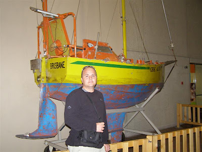

What would you consider the smallest size boat that could safely travel around the ocean?
Assuming of course the structural integrity of the boat is ideal for its size and form factor.
About this big.
There are a lot of boats that folks have plied the oceans in, but frankly many of them aren't especially practical except for the record breaking attempt.
I was commissioned several years ago to design the smallest, practical ocean capable sailor, eventually designing an 18' gaff sloop. It has a full size V berth, porta-pottie, mini galley and a safe, self draining cockpit, which was enough room to stretch out and sleep in too.
Much smaller then this and you're into the "micro cruiser" category, which for coastal cruising isn't so bad, but for deep water work is just too little boat for the most part.
To be frank, you should go to sea in the biggest boat you can afford or handle. Being in an ocean storm, on a 15' boat, is like climbing into a blender and pushing the "what was I thinking" button. There's an old sailor's rule which is, never go to sea in a boat smaller the the seas you'll encounter. Trust me on this, you don't want to be in a 15' boat in a 16' sea, which is a fairly common occurrence in deep water.

U-uh, this is one of those questions on which everyone will have their opinion, and there isn't really an answer.
Alain Bombard sailed across the Atlantic in an inflatable boat of 4.5 meters. I wouldn't call that safe though.
On the Mini Transat race sailors sail across in a 6.5 meter sailboats. Most of them survives :)
Practically, evetything above that is luxury :)
It really mostly depends on the skill and the personality of the crew. If you're (and I've misunderstood) asking what is the smallest boat that gets "ocean" class, that is regulated by the classification societies rules and so on ...
