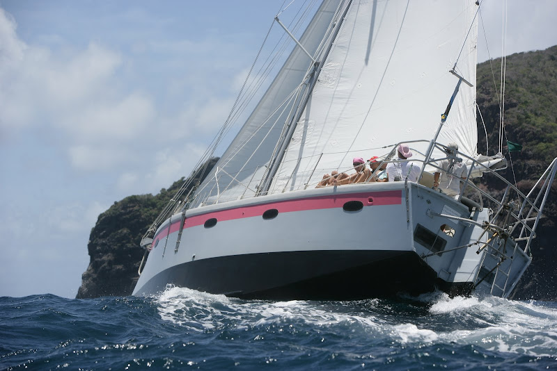

I have seen sharpies with vee worked into the stern , here is one
It adds to the complexity of building , but it is done .

As I look around at Chapelle, it appears to me that the New Haven and Carolina Sharpies were flat in cross section stem to stern,, Some with no skeg at all. When heeled the hull became a displacement V". In low winds, I guess if you held them flat, hulls with lesser rocker were said to be faster. ( I don't think there is a single Carolina Sharpie Schooner left. There is a pdf of a ≈ 44' hull in my first post.)
Skipjacks seem to have had some dead rise with a skeg (increasing wetted surface, but providing resistance to leeway as the leeward hull section from chine to the skeg ran level on heel.). ( Several Skipjacks have been preserved due to Va law's requiring sailing vessels for oystering.)
The stern quarter in the picture you posted has some dead-rise at the stern. Does it have a flat section amidships?
Also it seems to be running down by the Bow.. are there other pictures showing how she sets to windward?
I don't see much of a stern wave, which is good.
The rocker shown, which raises the lines to the WL, is the point of my deliberations. What is the trade off between the increased rocker which would seem to increase (Bernoulli) down vacuum on the hull, vs. " Suction" at the stern, if the stern is cut-off and the lines finish under the WL?
Bill PKS
