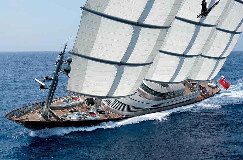

Something is very wrong with this boat.
look attentively, this boat seams having stability problem for a square rigger of this size.
He should have started with a proper hull, not a left over of Perini Navi from a client who didn't pay the hull.
It is a very bad decision. The rig is one thing but on a second hand hull designed for totally other purpose, it is really stupid.
You can spin that and snob that the way you want, but the reality is it is not a success due to the lake of purpose at the start. $60 million never impressed me, but I know it impress a lot of people. A sucker bought it anyway. For sale again in two year, you will see.

Daniel
What nonsense. Did you read any of this??
Interview With Maltese Falcon Chief Build Engineer and
YF Member; Jed White
"It's been 4 years since the Falcon took flight. How has boat held up? And the rig?
After 13,000 miles I’m still awestruck. The rig has performed almost faultlessly with only a small glitch in the operating system (designed by Cacini) and a couple of damaged sails (normally due to operator error rather than design or manufacturing fault). We’ve been across the gulf of Lyon twice in a Mistral once with over 65 Kts of wind (max 68) and at one point with only four sails up we hit a record speed of 24.8 Kts. We’ve had the deck under water almost every time we sail (15 degrees of heel) and a couple of times even the capping rail (25 degrees plus).
On my last day onboard, I went out in the tender while the ‘Falcon’ was sailing and even though I’d been aboard through all the build and all the sailing and seen all the photo’s, there’s nothing that can prepare you for the awesome sight of the ‘Falcon’ leaving her mooring or anchorage and within minutes all the sails are set and she’s charging through the water at 15 Kts almost effortlessly.
6. What are your thoughts on the future of the DynaRig concept?
I think the whole concept was a leap from the past directly into the future. Taking the square rig into the 21st century and proving that it could be done with the technology of today. I’m sure the technology will be used by Perini Navi and GDNP in future yachts and I hope one day to see many more yachts or ships with a ‘DynaRig’."
...and this
"As rigged and sailing, Falcon’s impressive design allows her to sail close-hauled at 45° from the wind, as opposed to the 55° or 60° of the traditional square-riggers of old. Here they show as one complete unit, all holding or changing course as directed by the helmsman at the computer screens. Her masts do bend to a degree under wind pressure, as noted, the 3.5 meters – 11.4 feet at the tip. Sail furling mechanism is worked by the electric motors inside the masts. Perhaps one of Falcon’s greatest advantages over the old style – besides her outstanding freshness and beauty – is her lack of standing rigging; via the DynaRig, invented by the German Wilhelm Drolls."
http://www.yachtforums.com/forums/perini-navi-yacht/13488-review-perini-navi-289-clipper-yacht-maltese-falcon-3.html
Brian wrote:
I would call this boat a great success, and I would praise the owner for being so bold to go forward with what had to be termed a risky project. Here...here...,lets have some more boldness in this conservative sailing business...not just the same old, same old.
"Sail, the historic implement of world exploration, has within itself many new horizons that beckon for pursuit, but you have to be willing to venture past charted waters." - Gary Hoyt
