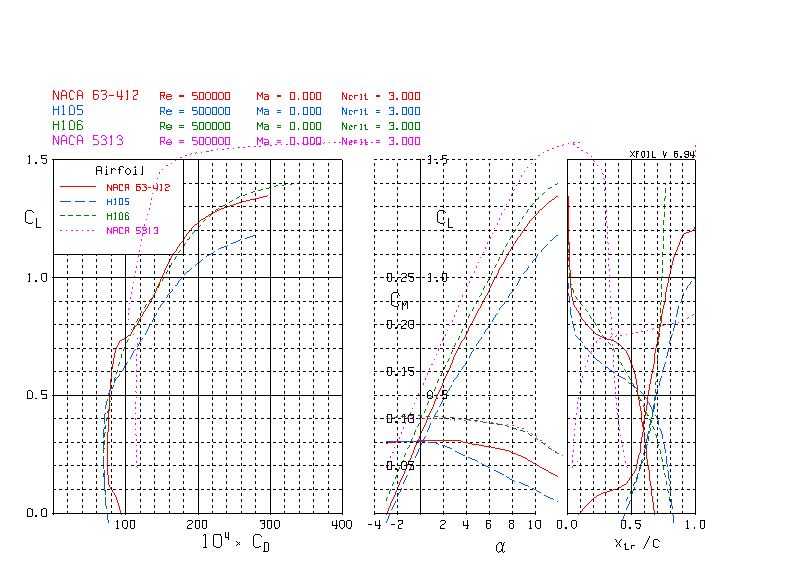

...With a cambered section, the minimum drag is not coincident with zero lift, so there will come a point where the Coefficient of drag is increasing while the lift is decreasing, which will lead to a lower top speed....
Not necessarily so. It depends on how much camber the section has. The key thing is to know what range of conditions you are interested in and target the section design to cover them.
One way to think about it is the designer uses thickness to trade off minimum drag (thinner is better) against being efficient over a wider range of conditions. Then uses camber to shift the center of that range so that it fits the application. For a lifting foil, you want the design range to include zero lift and a moderate range of positive lift coefficients. A symmetrical foil will have much of its design range wasted because its in the negative lift range that's of no interest in a lifting foil. The fact that the cambered foil has to be at a negative angle of attack to produce zero lift is immaterial - just mount it at that zero-lift angle where you'd mount a symmetrical section at zero incidence.
As for not producing minimum drag at zero lift, take a look at this example:
The four sections compared in this figure are the NACA 5313, a highly cambered front-loaded section, 13% thick; the NACA 63-412, a 1940's vintage laminar flow section, 12% thick; H105 a section I designed using the Eppler code, 12.5% thick; and H106 a section I designed using XFOIL, also 12.5% thick.
The NACA 5313 does suffer from excessive drag at zero lift. It really doesn't come into its own until Cl=0.8. It goes up reasonably well to Cl=1.4, but a hydrofoil probably isn't going to operate there.
The NACA 63-412 section has the classic 6-series drag bucket, centered at Cl=0.4 (the "4" in its designation). It has slightly too much camber to have minimum drag at zero lift. A NACA 63-312 section would fix this problem by shifting the drag bucket down by deltaCl=0.1
The H105 and H106 sections were intended from the outset to be used as sailing hydrofoils, so I made sure zero lift was included in their low-drag range. For the H105, I wasn't too concerned about the upper lift ranges because a hydrofoil boat has trouble rotating to high lift for takeoff. Once it's up and cruising, it doesn't need high lift, either. So I was content to have a design Cl=0.3 and a low-drag range that extended to Cl=0.5 - 0.6.
For the H106, I wanted to see if I could beat both the H105 and the NACA 63-412. So I resorted to the section designer's favorite crutch - aft loading. I built more aft camber into the section, as you can see from the increased pitching moment. I went back and forth between low and medium-high angles of attack to clip the formation of leading edge suction peaks that would have caused premature laminar separation, leading to early transition or leading edge stall. As you can see, I succeeded fairly well at meeting my goal - all exept for the very corner of the 6-series' drag bucket. And there's just a tiny amount of drag creep at zero lift.
So it looks like the H106 is a far superior hydrofoil compared to the NACA 5313, right? Maybe not. These are all non-dimensional coefficients that have the effect of area divided out. But say you chose a design lift coefficient of 1.2 for the 5313 compared to 0.4 for the H106. You could make the NACA 5313 foil 1/3 the chord of the H106's. This would cut the drag by 60% while producing the same total lift. Picture the NACA 5313 drag polar shrunk in the figure above until its zero lift drag half that of the other two sections! The maximum lift would shrink down to an equivalent Clmax=0.5, too. So you wouldn't have much margin left. But the NACA 5313 may well be the best of the 4 choices because it has the highest section L/D. And if you could stand the fact that structurally it would have 1/3 the thickness of the others.
I think you get the idea - there are lots of tradeoffs and it's not possible to make any blanket statements. Even with CFD, there's still plenty of art in design!

Tom, thank you very much for your nice explanations and for publishing the graphs!
I just came to another concern when talking about drag in non-foiling mode (from my point of view as a Moth sailor this isn't such an issue at the moment as we still have no restrictions on gear and are allowed to remove foils eventually, but I guess we aim at an allround solution with the foils fitted at all times...): I found my current existing Moth design goes pretty well in the (very) light stuff with the bow digged in almost up to the forestay fitting. In this case I think any foil section would produce both unwelcomed incredible drag and negative lift... Probably we need a foil arrangement that can pivot around the transversal axis of the boat (so to avoid a hinge at the centreboard's tip which weakens the joint) to have the foil at the right AOA. These adjustments would be done before hitting the water and left there. Doing this it may be possible to take the "ultimate" section with no regards on drag characteristics at 0 degrees of attack???
All the best, Olav
