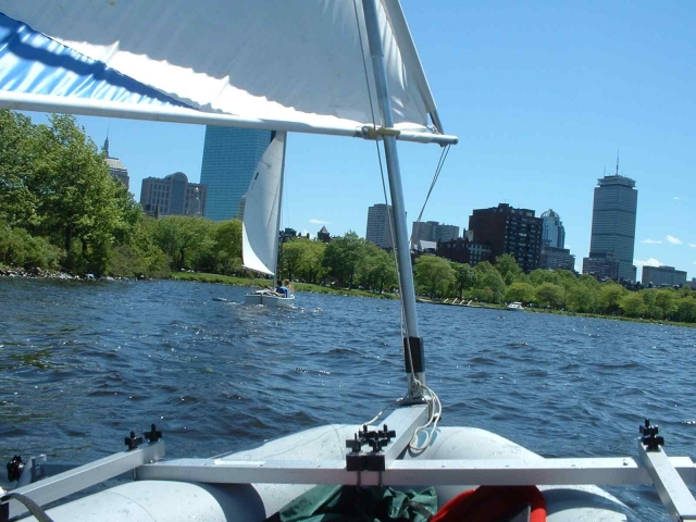

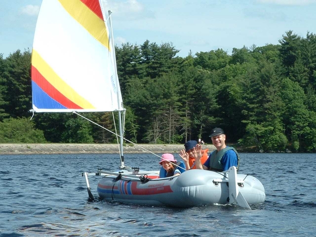

Thanks Figgy,
I was definately thinking of using polytarp,
the main problems I can imagine is how to step the mast, how to stay the mast, and then the daggerboards and rudder...
Here are a few photos from http://www.sailboatstogo.com/photo_gallery.php
a company that sells these sails,
Ha Ha,
ok,
it looks sorta nice
but at US$549
you can see why I wanto make my own.
Hans.
P.S.
what do people think of something like this?
any alterations or improvements on the general design?
Performance?
