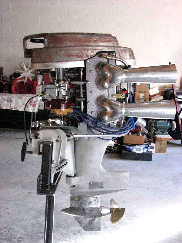

A strange prop design
Some years ago I was shown a propeller fitted to a mercury racing motor by an owner with a collection of outboards.I did not get the time to discuss the prop with the owner and did not get info about it.I have often thought about it and wish I had followed up on the prop.Does anyone know anything about such a prop as shown in the drawing? The owner is not incapable of pulling ones leg. It could be capable of putting a load on a motor for test purposes.

Are you sure it's not the other way around? I.e. the cavity on the back (fwd) side of the blade and the face (aft side) solid? It had some twist and an ogive section?

It is possible I have shown the wrong surface position and I realised this when drawing the diagram.The prop was small maybee 8 inches and I think it would be possible to achieve 180 pounds of thrust. It appeared to be made of fine metal and was well engineered.

Yes, it could be a supercavitating prop, but at that size (8" dia) it would be for a high rpm, low torque motor. So it was for a little 2-cycle hydroplane?

The motor would have been very high RPM and possibly direct drive or even geared up. It was wth a collection of other interesting old motors.About 30 HP range standard.

Like a Quincy Looper Mercury?
http://www.quincylooperracing.us/
or a non-looper merc.

But a test prop looks a bit like a water jet impellor.
Merc ones looked like 2 dinner plates one large one small with the blades between them ( like 20 blades)
Merc had the in the 60 and early 70's bit dropped them, I dont know why.
OMC/BRP still have them
The engine will run to a set rpm at WOT and sit there.
You can make them from very low pitch props by welding a ring around the blades (like a kort nozzle) Merc had a service bulletin on how to do it.
We used to use OMC ones on Merc (V6 and sterndrives have the same spline)
A great tool for troubleshooting

I think the design could have been one of Popeye's earlier ones, he may have had in mind this outboard rather than Quincy machinery.
