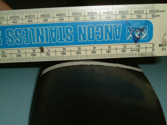

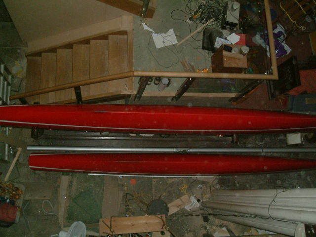

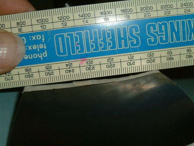

Anyway, Rick, I've taken some pictures of the Seacycle 16" props, and the Dart hulls. Forgive my naiveity, but I wasn't sure exactly what you meant by hull 'shape.' I have uploaded a simple plan and elevation of the hulls, but I couldn't find any proper Dart lines drawings; I will attempt a description.
The hulls are approximately 17 feet long at waterline. the 'keel' deepens gradually to the skeg point approximately 4 feet from the stern, where it forms a slight 'skeg' and then cuts back, running increasingly softly to meet the stern at the waterline. At the deepest point, the skeg, it is approximately 12inches below waterline. The plan at waterline runs smoothly and very gradually from a fine, pointy bow, to a maximum width of perhaps 11.5 inches, some 4 feet forward of the skeg. It reduces to perhaps 6 inches at the transom. The section is a deep, sharp vee at the bow, becoming a slightly bulbous vee toward the skeg. Aft of the skeg, there is a smooth transition from the bulbous vee to a shallow arc.
The hulls weigh approximately 40kgs each, plus two crew @ approximately 85 kgs each, plus say another 100 kgs for beams, ply deck and some gear. Say 350kg ish, plus or minus, displacement?
On the pictures of the seacycle props, I've marked a blade with tape in three positions, to highlight the section and pitch. From the hub, the tape is at 40mm, 100mm, 165mm. The corresponding pitch angles to the axis of the shaft are 30deg, 45deg, and 65 deg. approximately.
The seacycle units rotate the props anticlockwise when viewed from the stern, and the props and hence the spinner trail the drive unit.
Fastest cruising speed would be my priority, but I do see this project as a versatile boat; fishing and lobster potting, swimming platform, camping aboard (the deck will take a two person pup tent erected.) and sprinting:Burning off sailing boats on Windermere with my keen cyclist crew!
leading edge to the left.
leading edge to the right. concave underfoil surface, resembling MA409 profile from Javaprop.
'underview' of hulls in my dusty workshop
hull from skeg to transom in elevation.
I am reassured by your thoughts on the rudder position, Tinhorn, and by most of the other examples I have seen with this sort of configuration. If I did move the rudders forwards, towards the drive unit position, then turning the rudders would surely start to move the boat sideways, and diminish the turning moment? Do you have any threads/ web pages on your projects btw? I have found Ricks, and I shall go looking in detail after I've made this post. Many thanks.

The Seacycle prop should be OK. Your angle at 100mm radius seems low but the rest is about the right pitch. The blade chord is bigger than you need and could be trimmed with care if you wanted to optimise. As is might be better for one person but I have not checked this.
