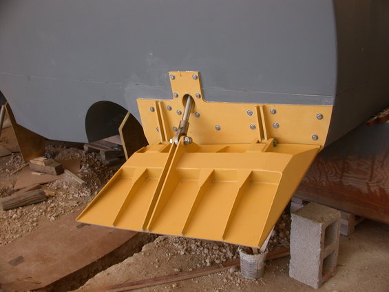

Something else to consider that is gaining acceptance - active trim tabs for roll damping/control (and in most cases pitch control too). Though usually reserved for hard-chine hulls that are operating at higher speeds (say 10 knots and above), the trim tab roll damping systems are often (usually, in fact) more effective than the fin stabilizers that would be recommended for the same hull and have the added benefits of not adding as much drag, being mechanically simpler (hence more reliable) and easier to install and not vulnerable to strike damage. For vessels with speeds above 25 knots or so, which is the typical limit for fins, the active trim tab solution is the only option for motion damping. Another 'cool' thing about active trim tabs is that the zero-speed control algorithms work quite nicely..but again there is the power required at anchor thing to deal with.
Active trim tabs take a bit more power to operate than fins do though. They are also considerably larger than their 'Bennet' bretheren and should be 'hidden' under protective cover of a swim platform to avoid striking them against quay walls and such. Tab on a 57' pilot cruiser hull shown in pic so you get what I mean. The swim platform was not installed yet.

The tabs in your picture are interesting; width is about 1/4 beam? Length about 2/3's width? You mention they are more effective than fins? Is this due to added area or lever arm? How about burying them under the boat, flush with the bottom, as is done with trim tabs? Or do they rotate up a lot?
Thanks for the clear discussion of the fins above.
